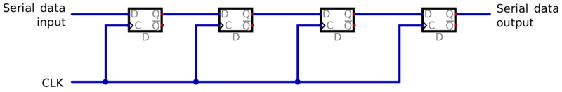

We built this circuit first:
This works as long as the microprocessor is reading the data the moment it has been fed completely. (After four clock pulses, the given four bits are completely loaded into the register. But no one is stopping the clock, so the shifting will continue. The microprocessor isn't expected to keep feeding the data, and the input will subsequently go LOW after the data has been fed. Therefore, from the fifth clock pulse onwards, the stored data will be lost, unless the μC starts reading it at the fourth clock pulse.) There's no "storage" option in it.

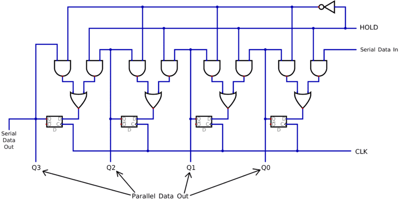

Our Prof. told us to build the controlled shift register next:
In this circuit, if I set HOLD to LOW, the output will be fed back, and thus, and the register will be able to store the fed data. This circuit, as far as I can see, works as both SISO and SIPO — if I set HOLD to LOW, it will work as storage, so I will be able to parallelly read the output lines Q3Q2Q1Q0 in this state (thus, SIPO). If I set HOLD to HIGH, the bits will shift, and I will be able to read the stored word through Q3 – thus, SISO. Am I correct in this evaluation?

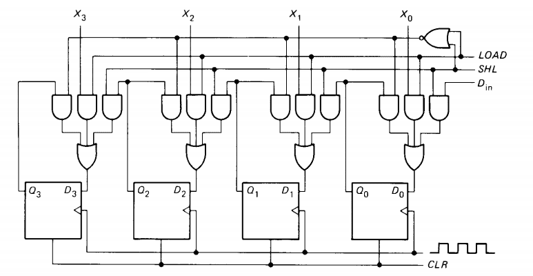

The real messy part is when parallel input comes into play. The book that we are following gives the following circuit:
Though huge, this circuit can be made to work in all the four ways (in my opinion):
LOAD​
SHL​
Mode of operation​
0​
0​
Hold / No change (⇒ parallel read possible)​
0​
1​
Shift left (serial out + serial in)​
1​
0​
Buffer register (parallel in through X's)​
1​
1​
Forbidden​
This circuit is difficult to be implemented in practice using basic gates, so the following circuit was proposed in class:

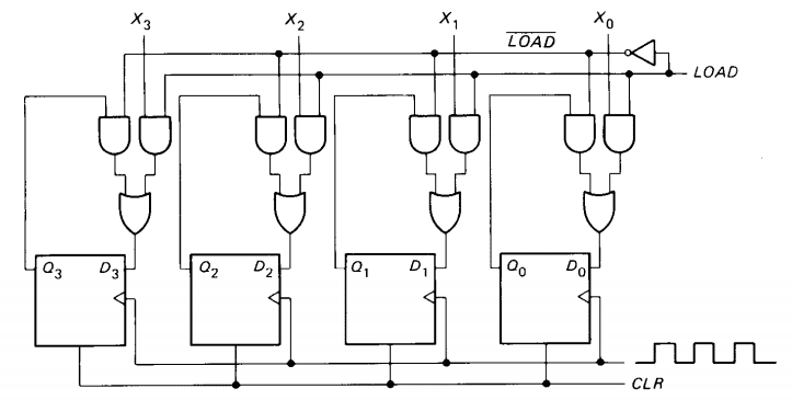

This is a buffer register and not really a shift register because there is no way the contents can shift in any direction. This is being proposed as the PIPO — parallel in, parallel out type. However, the flaw, in my opinion, is that this thing can't store. The μC will simply change the input lines once the word has been supplied to the register and one clock edge has gone (otherwise, what's the use of using a storage element?). Hence, everything that was stored will be literally lost at the next clock edge. To really store, we need a control, like the circuit below:
Here, the data will be stored if I put LOAD to LOW, and hence, parallel input (LOAD = 1) as well as parallel output (with LOAD = 0) will be possible. This can work as a PIPO register.

Basically, you have a register that can hold four bits for one cycle.
The input for each bit, when clocked, can come from one of four inputs.
0. The bit to the left, (shift right).
1. The bit to the right, (shift left).
2. The parallel input, (parallel load).
3. The resident bit, (hold data).
A four bit data selector, is less complex than a 'D' type flip-flop.

Let me get this straight. For a simple 4-bit SISO register, the full word is stored after four clock edges. And it is read serially starting from the fourth clock edge itself. Is this correct?
Wrichik Basu said:
Is this correct?
Yes, and you can build any length register by chaining modules of four bits together.

Not if the input data selectors: Reload the resident bits, (hold data).
A register does not exist in isolation. It must be connected, controlled and synchronised by external logic.
Some universal shift registers have an added parallel output holding register, so the input register can be loaded asynchronously, with the external outputs holding their state, until commanded to update.

Anyway, just clarify this: is parallel readout possible without an option to hold the data?
You can read the parallel output at any time, but if you are shifting left or right, in or out, at the time, the data will be invalid. It all comes down to timing.
