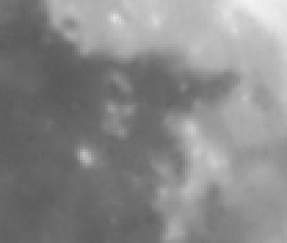

So now I'm using the Nikon lenses without a lensed adapter, and the difference is more than I guessed: here's a 400% crop (no interpolation, jpg straight out of the camera) of the moon, taken with the Sony:

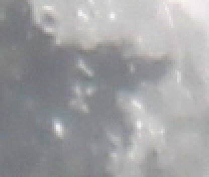

The zoom makes it hard to tell, but this image is extremely sharp- this particular feature on the moon is one of the 'benchmarks' I use to judge atmospheric distortion, camera shake, etc. Now here's the same area taken with the Canon (also jpg, straight off the camera):
The difference is quite dramatic and results only from the lack of an intermediate lens- the pixel pitch is similar.

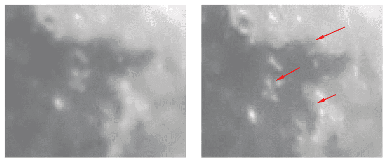

Is it just me, or does the bottom picture look more detailed than the top?
It's just you. The bottom picture looks more detailed because it is more strongly pixelated and thus has sharper edges so looks more detailed but actually has lost some of the gradations. That is, it looks sharper, but that is not due to a correct representation of reality but rather an artifact of the pixelation.
I disagree. I know what you're getting at, and I examined this carefully for that very thing. Edge contrast is certainly a factor in making a picture appear more detailed than it is, I agree with that.
But I see finer gradients and more detail in the areas where it's not burned out. I would say these are bona fide details.
It's a tough call. You may be right. @Andy Resnick, what say you?

I think the lack of an adapter lens results in a sharper image. Plus, there's no vignetting. The difference is even more dramatic off-center.
agreed, the less glass in the path is always a good thing :smile:

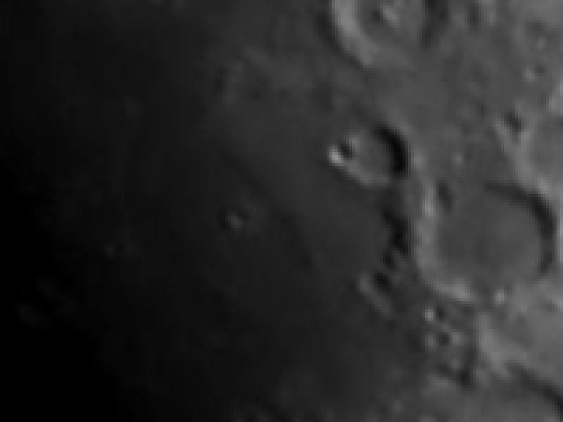

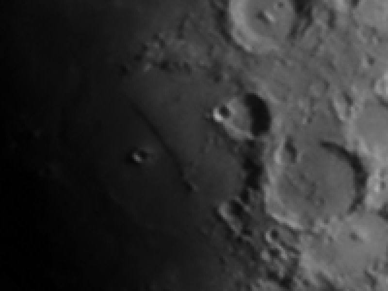

More data showing the effect of a lensed adapter; these are images of Rupes Recta, both jpgs taken with identical settings (800/5.6, same shutter and ISO settings). This feature is about 2.5km across, with a height differential of only about 300m. The images are scaled 400%, no interpolation. If printed as displayed, the moon would be about 5 feet in diameter.
First, the Sony:
Next, the Nikon:
It's like a veil was lifted off the lens...
That is quite an improvement.
