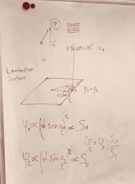

I have a small project in which I try to use a Time of Flight camera to detect movement in the Field of View.
Now the current Field of View is really narrow (about 25° diagonal FoV), which is we I will have to simulate a bigger one.
My professor did try to explain to me what changes, but to be honest I could not follow his explanation, since I'm a real beginner when it comes to optics. Now that I did some research on the theme I have a lot of questions regarding the theme, but could not find any suitable explanation yet, so here I am :)
So what I do understand is that a Time of Flight camera emits light with a transmitter and has an receiver, which measures the time of flight of the transmitted photons to get distance measurements.
Now to things I am not sure about.
-If I would like to have a bigger FoV. Do I need to use a lens on both the receiver and the transmitter or only the receiver?
-What properties change when I use a different lens in my system(luminous flux, power consumption)?
-Is there a way to calculate how these properties would change?
-and my final question is to the brief introduction that my professor gave me, where I made a picture of a formula which I did not really understand(I appended it as a picture). I know that the formulas are about two different lenses, with different FoV. But what exactly is calculated there? If it is the observed surface area of the different FoVs, shouldn't it be ## \varphi \propto (d * tan(\frac{\alpha}{2})*2)^2 ##, when d is the distance to the object and ## \alpha ## is the Field of View

What do you mean by a "time of flight" camera? Are you measuring the time for a light pulse to cross a gap (that will be around one foot per nanosecond)?
The optics can spread the pulse out if the distance traveled is not the same over the beam.
Have I got it wrong?
I'm using the VL53L1X camera of ST.
To detect something it has to be both in the beam of the light source and in view of the camera. I don't know what your 25 degrees refer to, but you'll have to consider both sides if you want a larger field of view.

Sure, you can simulate the optics.
##\sin \frac \alpha 2 \approx \tan \frac \alpha 2## if the angle is not too large, and for an "is proportional to" relation the factor 2 does not matter.
I'm sorry I meant 27° and it is the the listed diagonal Field of View in the datasheet.
I don't know if the light passes through the same lens for transmitter and receiver.
So from what I understand using a wider angle lens would mean, I would definitely have to adjust for that one the receiver and the transmitter.

But the OP has quite a few hidden difficulties and the basic answer is that the illumination needs to have a similar angular field or you will waste light energy or have a dark surround to the scene. (Just as for a good camera flash with Zoom, linked to the camera lens). Geometry (as discussed) can tell you the resulting light level thrown back. However, once the angle gets wider than around 10° from the axis, there is significant drop of as the hypotenuse (to the edge of an illuminated plane will increase as 1/cos(Φ). This can be corrected for, of course.
A "program", as such is not needed. All that you need to do is some simple trigonometry on your calculator.

I have to wonder what your Professor told you about this and what he actually expected you to know already. The basics of what happens to the light are the same as for pretty much any optical system. The effect of distance when sources are fairly small is just Inverse Square Law.
Details of the "throw back" (reflectivity) are not important for this calculation because the same thing applies for the unmodified system. All you need to know is the distance traveled by the light from the source and use ISL to find the light flux density from the centre relative to the edges. This is simple trigonometry and the Cos of the angle tells you the length of the hypotenuse. I can't imagine that a specific program has been written to do what you want; it such basic Physics and Geometry.
A unit for power flux density could be Wm-2 but the spec will help you there.

The goal is to see the differences between different lenses in the area of the existing 25° and 90°. More specifically, what kind of drawbacks are to expect by using a wider angle lens. The datasheet says that the camera has a maximum distance of 3m+ with the current lens. But If I start emitting with the same power as before there should be a considerable smaller maximum distance with a wider lens.
And the other question is how would objects scale on the different field of views. How will I have to scale a person (what size should the person have) walking through the narrow FoV to be representative of the wide FoV. Can I just scale them according to the surface area that is spanned by the FoV:
for 27° diagonal FoV and a distance of $$ 2m = 0,46m^2 $$
for 80° diagonal FoV and a distance of $$ 2m = 5,63m^2 $$
so a scale factor of $$ \frac{5,63m^2}{0,46m^2} = 12,23 $$
or will I have to consider other properties.

For a given object at a given distance, the reflected power is going to grow smaller as the FoV increases since the light is spread out over a larger area before reflecting back. The object will have to be closer to the camera for the same signal to noise ratio, as Sophie mentioned. Another thing to think of is the change in the resolution of the camera. You're not increasing the number of pixels, so each pixel is going to see a much larger portion of the FoV than it did before. This may or may not be desirable.
That looks plausible to me.

With 90°FoV, at the corners you will get only about 6% 12.5% of the signal strength due to Lamberts Law (COS4 fall-off, see http://dougkerr.net/Pumpkin/articles/Cosine_Fourth_Falloff.pdf, which applies to both the light source and the detector). Of course the distance calibration will vary across the FoV because of the slant distance to the target.

Oops! You are right. That 6% should be 12.5%. At 90° FOV the half-angle is 45°, COS(45) = 0.707, 0.7074 = 0.25; times 0.7072 = 0.125. Will correct in my earlier post. Sorry.
End Edit:
I considered the COS4 fall off of the imager, and assumed the illumination fall off to be only COS2 because there is only one surface invovlved. I think this would be valid at least for a steered illumination beam
