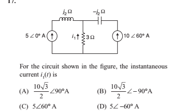

Can I use KCL at the central node?
I tried KCL and got: 5cos0 + j 5sin0 + 10 cos 60 + j 10 sin 60 = (-I1)
5 + 5 + j 10 *1.732 / 2 = (-I1)
10 + j 5 * 1.732 = -I1
This gives 13.33 angle (220.89)
Book answer is A
Is the 5 and 10 Ampere in figure, RMS or Maximum?

Instantaneous values have no phase. So in that sense, the options seem meaningless.
In India, I guess they are taken as peak quantities unless specified otherwise.
I agree with your calculations.
Maybe they have given instantaneous values of the magnitudes and phases of the current sources (in an incorrect way) and they want you to find the magnitude and phase of I1 at that instant.
