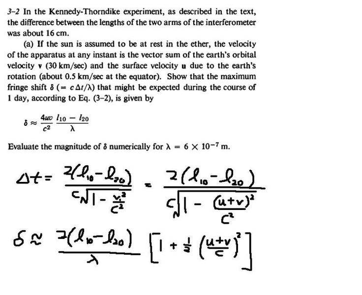

In summary, the maximum relative velocity of the ether wind is determined to be (u + v) where u and v complement each other. There is a factor of (1/2) beside the square in the expression for the difference in Δt between maximum and minimum relative velocities. The correct term for the problem is '4uv' rather than '2uv' as initially calculated.
unscientific
1,734
In this problem i take the maximum relative velocity of ether wind to be (u + v) where they both complement each other..
Not sure how they ended up with a '4uv' term..
Would appreciate any help..
Good. What would the minimum relative velocity be during the day? δ is the change in Δt(c/λ) in going from maximum to minimum relative velocity.
I got very close to the answer, just that my term had a '2uv' instead of a '4uv'..
Did you calculate Δt for both the maximum and minimum velocity relative to the ether and then take the difference between these two Δt's? Also note the initial factor of 2 in the expression for Δt.
Yes, but there is a factor of (1/2) beside the square...
Ah, I see my mistake now..
