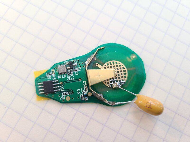

Gave it a try with a 100[uF] tantalum capacitor on the terminals. Not a single blip from the HackRF.
When you remove the battery does the +ve battery terminal short the power supply by contacting the -ve terminal on the pcb? Especially if you have it the other way up to press the buttons. Try replacing the battery with cardboard when on the power supply.
The LED lights when the button is pushed.
