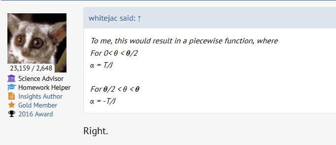

To me, this would result in a piecewise function, where
For 0< θ < θ/2
α = T/J
For θ/2 < θ < θ
α = -T/J
For 0< θ < θ/2
α = T/J
For θ/2 < θ < θ
α = -T/J
Right.

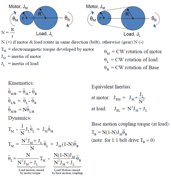

I've been working on this most of the day between work.
Here's what I've come after studying some notes my professor put out and trying do it. This relates the torque with the two pulleys in terms of J and alpha.
His notes have a dynamic expression for belt driven pulleys with a rotating base:
Tm = Jmαm +1/N * JLαL, where N = R/r
And
m = RαL <- this is the expression we've been tossing around.
=> αL = r * αm / R
Then
Tm = Jmαm +r/R * JLr * αm / R
(R2 / r2)(Tm - Jmαm) = JL* αm
R = SQRT[((r2)JL * αm) / (r2)(Tm - Jmαm)]
However, if Tm = Jmαm only applies to a motor without a belt attached, then I am still left with 1 equation and 2 unknowns
You have not used the fact that the time is to be minimised.
How would this look? From what my professor has told me, you set the torque to its max so that your arm/pulley/etc uses the minimum amount of time (though you'd factor in some safety in a real application because it's highly idealized)
Yes, but in this question you are asked to find the R which minimises the time.
