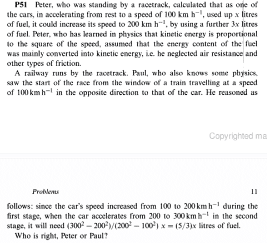

watz gung wrong here

I'd lose the attitude, I'm not going to tell you the answer. The rules of PF are that I cannot do your work for you and I have no intention of doing so. I can only provide you guidance.
So let's get you started.
What is the formula for kinetic energy? What are the two relevant formulas for work done?

I've just derived the answer on a pad in front of me for you.
I can tell you it's relating to the KE work done and velocity equations.

EDIT: Forget that. The answer is more obvious than all my workings here.
Look at the values for speed quoted. What is wrong with Pauls speed values?

Look at the speeds quoted in the question and where Pauls reference point is. What is wrong with his speeds.

So Peter is right saying it will take 3x litres of fuel to go from 100 to 200 and Paul is right saying that it will take (5/3)x litres of fuel to go from 200 to 300?
Are you telling me it would take less fuel to go from 200 to 300 than it would 100 to 200?
Again, look at the values for the speeds - there's something wrong with one set of speeds.

the train in moving in opposite direction of the car and hence in train frame of refrence corrolay pauls frame of refrence the initial speed of car is 100 and after consuming x amount of fuel it will be 500
Where did you get 500 from?
The kinetic energy to go from 100 to 200 for the car will be the same, regardless of frame of reference. The train is independent and Paul is making a mistake by adding the trains velocity into the equation.
The car goes from 0 to 100 and then 100 to 200. The fuel to go from 0 to 100 is not the same as the fuel to go from 100 to 200. The fuel to go from 100 to 200 is not the same as the fuel to go from 200 to 300. So with Paul using these values he is incorrect.
You can't add the trains motion into the equation because it is independent of the car. The kinetic energy for acceleration of the car isn't affected by the train.

the fuel required for 0 to 100 in peters frame is same as the fuel required 100 to 200 in pauls frame...and if u are trying to sat that paul is making mistake by adding trains velocity then how how can conclude that he is making a mistake...becuase he can never know whether he is moving or the car is moving
Yes it is, but in his equations he uses it wrongly and includes the trains velocity. If you include the trains velocity, you are including the kinetic energy of the train.

Here is the final explanation:
The energy to go from 100 to 200 is not the same as 200 to 300. Therefore the fuel requirements are different.
If Paul ignores the trains speed and uses 200 to 300 for the second section his V2 values for KE are going to be much higher.
V2 = 2002 = 40000
V2 = 3002 = 90000
That is a significant difference in energy values. You have to put in more than double the fuel to get to 300 than you do to get to 200. So if you don't compensate for the trains speed you end up with the incorrect energy values - because the car is not going to 300. Change in KE from 100 to 200 = 0.5m(2002 - 1002) =/= change in KE from 200 to 300 = 0.5m(3002 - 2002). So the readings gained by both people are not the same and hence cannot both be right for the second stage.
Pauls reference frame can be what ever he likes, it could show the car going from 1000 to 1100 but the energy used by the car will always be the amount to go from 100 to 200. You have to compensate for this based on your reference frame.
What ever speed Paul records must be altered to allow for the trains velocity.

From Paul's point of view the car accelerates from -100 to 0 for the first section, then from 0 to 100 for the second section.
This same issue has been brought up a couple of times recently. If you include the energy change to the earth, and consider Earth and car as part of a closed system, then ignoring losses to heat, the total energy of the system is conserved, and the total kinetic energy gain is equal to the total chemical or electrical potential energy consumed by the engine, as observed from any inertial (non-accelerating) frame of reference.
If the effect on the Earth is going to be ignored (earth with infinite mass), then the frame of reference must correrspond to the point of application of force, which in this case, is the road, since that is where the force is being applied by the tires of the car, and since the assumption is the road is attached to an Earth with infinite mass (no energy gained by the earth).

Correct, that is compensating for the trains motion. But, in the question Paul goes wrong and uses 100 to 200 and then 200 to 300 for the energy values.
