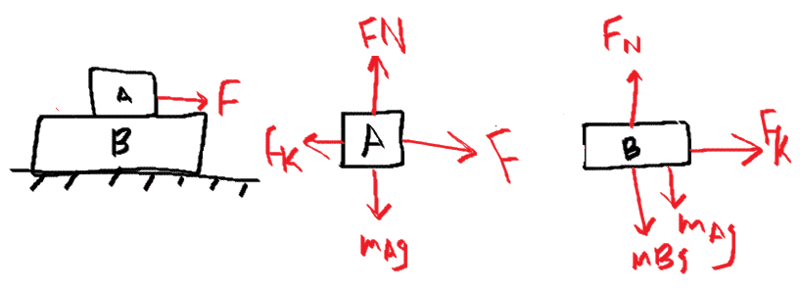

just to be sure can you please tell me if this Free body diagram is correct or not incase the upper block is the one being pulled by the force not the lower block. so i make sure i am understanding it right ! please check the attachment and forgive me for my bad drawing!

OK, not bad.
As long as you realize, as I'm sure you do, that the normal forces are different.
On block A, block B exerts an upward normal force that happens to equal ##m_Ag##.
On block B, two normal forces act: A downward normal force from block A that equals ##m_Ag##, and an upward normal force from the table that equals ##m_Ag + m_Bg##.

Yeah, i Know that but I found it somehow hard to write with the painter :) ( you can see how I am struggling to write the letters ^_^) Anyways thanks a lot, I must have pointed the difference in fn to avoid any confusions for other readers! Appreciate your quick Help.
