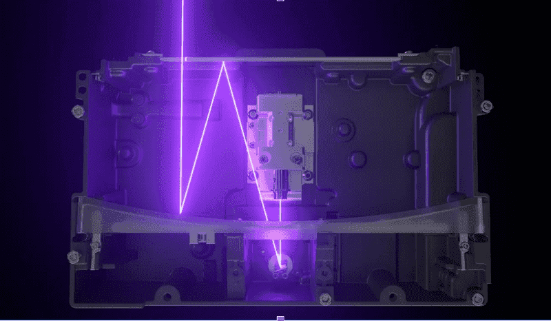

- How would I go about selecting the best optical path so I get a nice, tight, controllable, focused beam to form my scan or image? I notice the SLA 3D printer, "Form Labs" uses a laser, focused on a galvometer, bouncing off a large flat first surface mirror, and a parabolic (focusing?) mirror, before it is projected over a build area of around 300x300mm (below).
- Is this complex path needed?

The system you show is only a 1D system, so the flat mirror does not obstruct the parabolic mirror. 2D is impossible without a diagonal optical path and a 2D galvanometer.
Note that a 2D parabolic mirror is needed to keep the ray perpendicular to the target, so it must be the same size as the target. That would be circa 710 mm diameter for the 500x500 mm target.

For the beam path I provided, it actually is in 2-D --- the actual printer I own, and it scans the bottom of a translucent plastic build tray in the exact pattern of each layer of a 3D part... then moves it upward and does the next layer.

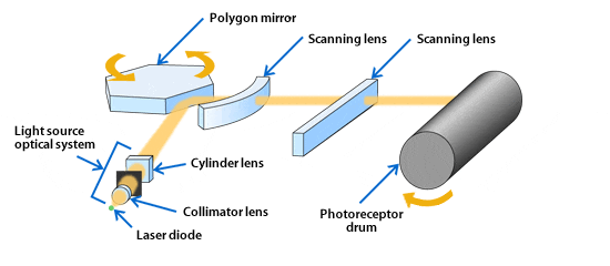

I do believe you are correct with using a 1D scanning method. Something like:
Laser diode -> focusing lens -> spinning scanning octagonal mirror with an optical encoder on the motor -> then a diverging meniscus lens -> concave lens...
or
or
and move the workpiece on a set of acme ball screws for the 2nd dimension, slowly forward.
Is there any good way of calculating what last 2 lenses I need? Is there like an Ansys of optics? or a SolidWorks focused on optics?
Thanks for your thoughts!
Ted
A source of Laser scanning motor. mirror, optics is a replacement scanner for a Laser Printer.
However there tends to be no documention available for them, so you are kinda on your own for a drive circuit. If you can get a service manual for the printer you can likely find a little info though.

To be laser wavelength independent, avoid lenses, use front-face mirrors for the polygon and optical system, except as fitted to the fixed laser module.
Notice that the curvature of the parabolic mirror will to some extent focus the laser along the optical-scan dimension, while the straight mirror is actually made slightly cylindrical, to focus the laser in the platen-movement dimension.
