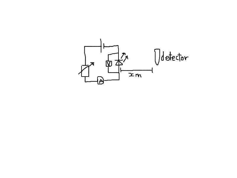

ok i have looked at what you've said.
so if i had a circuit like
the question asked to keep the current the same at all times, so id vary the resistance so that the current is the same for all 3 LEDs, so the energy supplied is the same. id keep the detector (which would detect the no. of photons going past it) x meters away at all times. and the room should be dark so it doesn't alter the results. use the detector to measure the no. of photons that is being emitted from LED in a given time interval. the higher the no. of photons, the higher the light intensity.d
is everything i said valid? btw i don't literally have to do the experiment, just have to say how it would be done. its 5marks.
please would anyone correct me with anything wrong with what I've mentioned.
If you want the current to be the same then why not connect the LEDs in series? Simples.
Then adjust distances from detector / camera for equal.readings for each LED. A webcam could give you a picture on the monitor and the 'light meter' software could be used directly on the three images, in turn, till you get the same values
To get your five marks you need to identify all the variables and showing how they are controlled and measured. Check that you have all the variables and that you've described a method in full.
