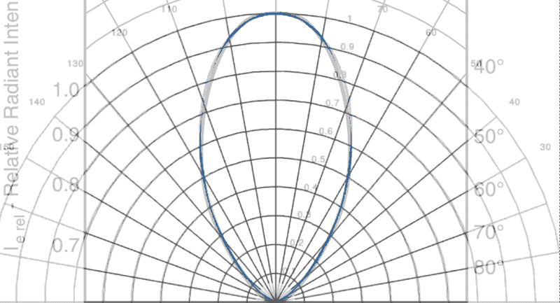

Consider the infrared led TSAL7600 which has the following properties:
$$ \Phi = 35 mW $$
$$ I_e = 25 mW/sr $$
The half angle is ## 30^\circ ## and:
$$ I_r(\theta) = cos^{4.818}(\theta) $$
is a good approximation for the relative radiant intensity.
However, finding the actual radiant intensity is eluding me. I'm looking for something like:
$$ I(\theta) = I_e \cdot I_r(\theta)$$
where ## I_e ## is the peak intensity. If it's correct, then integrating over the surface of the relative radiant intensity should give the radiant power:
$$\Phi = \int_{0}^{2\pi} d\phi \int_{0}^{\pi/2}I_e cos^{4.818}(\theta) sin(\theta) d\theta $$
$$\Phi = 2\pi I_e \int_{0}^{\pi/2} cos^{4.818}(\theta) sin(\theta) d\theta $$
And thanks to integral-calculator.com
$$ \Phi = I_e \cdot 1.0799 $$
$$ \Phi = 26.997 \neq 35 $$
That's obviously nowhere close.
The above integral came out of a paper called Improvement of the Approximation Accuracy of LED Radiation Patterns, but I had already found ## cos^{4.818}(\theta) ## by playing around in octave so I didn't use a nice round number like 5 (with a nice solution). I presume the integral finds the surface area of the radiation pattern since I've seen similar elsewhere, but I don't claim to know what I'm doing. I'm an Engineer. but this is not my area of expertise.
In the paper, they use the radiant power to solve for ## I_o ##, the maximum intensity, which I believe is the same thing as ## I_e ##.
This integral:
evaluates to ## \approx 1 ## and I need ## \approx 1.4 ## to get the correct radiant power. That means one of four possibilities:
1. the integral $$\Phi = \int_{0}^{2\pi} d\phi \int_{0}^{\pi/2}I_e cos^{n}(\theta) sin(\theta) d\theta $$
is not correct
2. the datasheet distribution does not match the real distribution. If the actual half angle were more like ## 35^\circ ## for which ## cos^{3.487}(\theta) ## is a better fit, the integral evaluates to ## \approx 1.4 ##.
3. the actual distribution is not approximated well enough by ## cos^{4.818}(\theta) ##
4. the required 'fudge factor' is ## 1.4\approx \sqrt{2} ##. Is it possible that ## I_e ## needs conversion by ## \sqrt{2} ## to become ## I_o ##?
Can anyone offer up an explanation as to why the radiant power is not correct?
The goal here is to go from ## \Phi=35mW ## to ## I_e=25mW/sr ## using the estimated radiant distribution. I would like to eventually calculate the radiant power over a smaller angle.

Isn't there there a factor ## \cos \theta ## missing? I'd expect the flux to be given by $$ \Phi = 2 \pi \int_0^{\pi/2} d\theta \sin \theta \ I(\theta) \cos \theta \ , $$ because the intensity refers to the projected area.
I'd think that only one of the quantities is reasonably accurate. Have you checked with the company?
I think ##I(\theta)=cos^n(\theta)## is the far field radiation pattern which assumes a point source. I don't know if that explains it. There's also the assumption that the radiator is lambertian.
In more basic terms, adding a cos term would only increase n. Increasing n gives a smaller number from the integral which is going the opposite way.
Going by the units, the radiant intensity is power/solid angle. That solid angle I think comes about via ##d\phi d\theta##. Perhaps. I haven't yet convinced myself.
Getting back to the lambertian radiator, if I understand it correctly the integral of ##I(\theta) = cos(\theta)## should give a result of pi:
$$ 2\pi \int_{0}^{\pi/2} cos(\theta) sin(\theta) d\theta $$
And it does.
So perhaps the explanation is that neither the point source nor lambertian radiator are valid assumptions for this LED?

Correct. If you assume a Lambertian radiation pattern, i.e. ##I## independent of ##\theta##, you get a factor ##\pi##, as you have checked yourself. The peak radiance of ## \rm 25~mW~sr^{-1} ## would then imply a flux of ## \rm 78.5~mW ##.
You can make flux and radiance consistent, if you assume ## I(\theta) \propto \cos^n\theta ## with ## n \approx 2.5 ##. (The effective solid angle is ## 2 \pi \over n+2 ##.) I'm not sure if the diagram could be viewed as consistent with that.

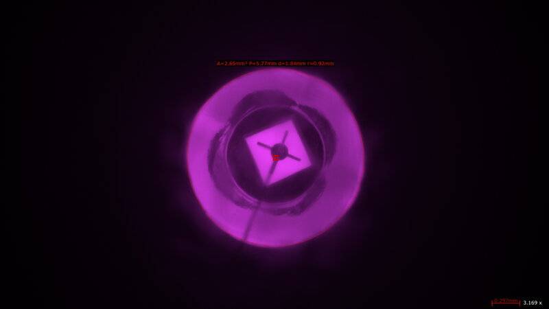

Perhaps not, but that specific integral does. I took a look at a 5mm IRED under the microscope at work (this is not the Vishay IRED).
It doesn't look like a lambertian emitter. Maybe the central die does (it's 0.5mm x0.5mm), but that reflecting ring doesn't?

Intensity proportional to a power of ## \cos \theta ## is not a physical law, but merely a convenient parametrization of the radiation pattern. A different pattern is quite possible. Unless you can measure the angular dependence yourself, with the data at hand you can only obtain ballpark estimates.

I really appreciate this. I've been going a little crazy trying to understand the issue.
I shouldn't have to measure the angular dependence (and I'd need a calibrated detector). The manufacturer should provide that information. I normally treat all the information contained in a datasheet as law. It's been my experience, at least with the components I regularly use, that datasheets rarely have errors. The data at hand should be accurate.
The Radiant Intensity Distribution graph should have a disclaimer on it though. Something about it being a crude estimate.
From the picture I posted above, this chip clearly has a bond dot in the centre of the die. And Figure 9 shows the difference in radiation patterns between a chip with and without a bond dot.
So it's probably safe to assume that the intensity exactly on-axis is actually lower than expected. And I guess this could agree with the observation that the shape of the bond dot radiation has more surface area than ##cos^{4.818}(\theta)## with matching ##\frac{1}{2}## half angles.
The troubling part for eye safety is that the peak Radiant Intensity is likely higher than the average around the bond dot as measured on axis over ##0.01sr##. I should probably err on the side of caution and use a higher Radiant Intensity, perhaps 1.4 times higher? Maybe 2x higher?

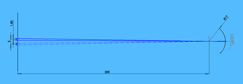

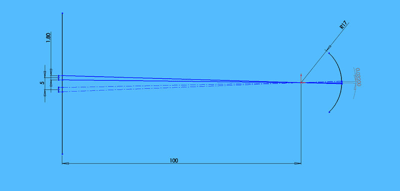

Here's what I think.
The standard model for the human eye has a focal distance to the retina of ##17mm## equivalent in air [1].
The ##5mm## spacing imposed by the LED body means that the smallest subtended angle between neighbouring apparent sizes of ##1.8mm## is:
1. ##0.032 rad## for a ##100 mm## distance
2. ##0.016 rad## for a ##200 mm## distance
At these distances there is no overlap on the retina. And I guess a decent safety margin. The closer you get the farther apart the images on the retina and the larger the image becomes. So the danger there is not from overlap. The farther you get from the LEDs, the closer the images on the retina become and the smaller the images become. So the danger there is not from overlap either. Maybe this is pretty obvious, but I needed a diagram.

$$\alpha = \frac{0.5}{100} = 0.005 rad $$
This is less than the minimum ##\alpha## so the standard instructs us to use ##alpha = 0.011##. Plugging that into the limit:
$$L_{ir} = \frac{6000}{0.011} = 545 \frac{mW}{mm^2sr}$$
The AN090 application note gives an approximation that I've already explained is not applicable to 5mm LEDs. I can calculate a worser case Radiance by using the virtual die area (0.5mmx0.5mm) only and the total ##I_e##, but I don't have a lot of confidence that this is even right given the nature of how ##I_e## is calculated. Still, if we use the values for the TSAL7600:
$$L_{ir} = \frac{I_eR(\lambda)}{Z^2} = \frac{25*0.33}{0.5^2} = 33 \frac{mW}{mm^2sr} $$
