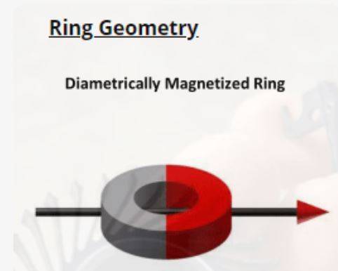

try and see if you can get your supplier to give you exactly how that ring magnet is magnetized. turns out there are a lot of ways you can magnetize ring magnets, as per this source.
anyway, I'm really hoping your ring magnet is magnetized this way, try and see if you can confirm this experimentally, before we attempt to tackle the 3-phase voltage generation problem:
Diagram titled Ring Geometry showing a ring magnet split into a grey half and a red half, with an arrow through its axis, labelled Diametrically Magnetized Ring.
if it is, then it's the same operation as with the ring segment type in the youtube video i linked on 3-phase BLDC operation. problem half-solved.

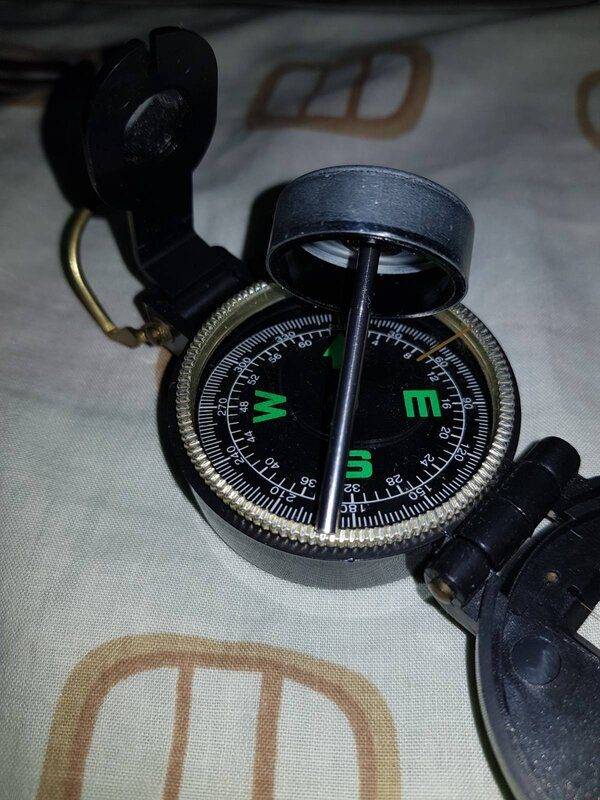

I tried it with a compass for many positions for almost 20 minutes (I don't have a tiny bar magnet I can insert inside the ring). I noticed the following positions that can deflect the north of the compass toward the bottom or up (irregardless of the rotations). Can you figure out what kind of magnetic configuration the ring uses? (note the metal housing the encloses the ring magnet inside it)
Black military-style lensatic compass with a green-lettered dial showing N, E, S and W, its sighting wire standing up over the dial and the lid partly open.
Photo of a black lensatic-style military compass with a green-marked dial reading N, E, S, W, its needle pointing toward the viewer, lying on a patterned bedsheet.
jake jot said:
can you try and keep the rotor in this position while turning the shaft slowly and see if your compass north stays up, or does it go down at some point along rotation?
It doesn't go down in any rotation of the shalf. I tried that many times. Isn't it the magnetic north of a magnet is really south?
yup. next, set the rotor as in the second position, but with shaft in line with the needle center. slowly turn the shaft while keeping this position. is there any kind of response from your compass?
Yes, it rotates. I think the magnetic configuration is like this.
Diagram titled Ring Geometry showing a diametrically magnetized ring, a 3D ring split into a grey half and a red half, with a black arrow passing through its centre pointing right.
Thanks :)

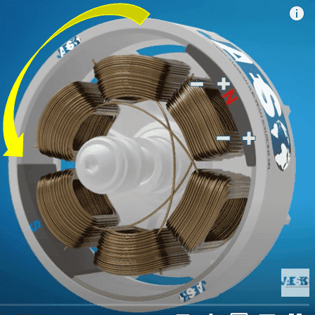

for just a while, let's limit our analysis to one stator pole, as follows:
Cutaway 3D render of a brushless DC motor showing a grey outer rotor ring with magnets, a central stator of wound copper coils on pole pieces, and a yellow counter-clockwise rotation arrow at upper left.
with a rotor rotation direction given by the yellow counter-clockwise arrow, and each single coil of your solenoid having its return path being subjected to the same direction of flux, at the same relative rotational speed and direction, how much voltage would you measure at the terminals of this solenoid?

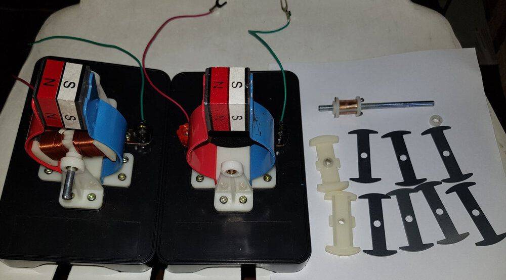

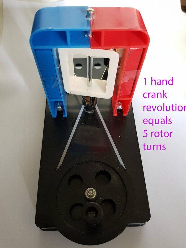

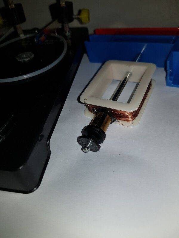

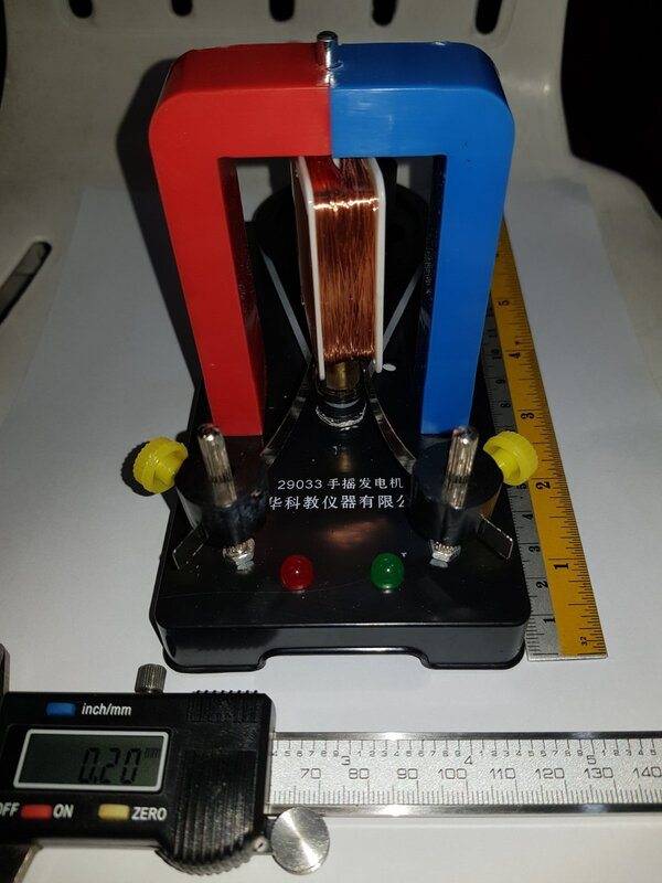

Here is the amazon generator. It's much smaller than it looks.
Amazon.com: EUDAX School DIY Dynamo Lantern Educational STEM Building ,Labs Demonstration Motor Activity Teaching Model Hand Cranked Power Electricity DC Electric Generator Physical Science Experiment Education: Toys & Games
Photo of a hand-cranked demonstration generator with a red and blue horseshoe magnet, a copper coil rotor, and a digital caliper reading 0.20 mm beside it.
The length from front to back is about 6.5 inches. The magnetic wire diameter using the caliper is about 0.20mm (0.0078 inches).
Photo of a small hand-cranked DC generator demonstration model with a blue and red horseshoe magnet pair, a copper-wound coil on a central rotor, and a black base with a crank handle, beside a ruler and a digital caliper.
The size of the magnet (solid red and blue either side center) is about 2 inches long, the white winding plastic is also 2 inches long, and 1.5 inches wide.
Using a multimeter, the current is 10 milliampere at the fastest i can rotate it using the hand crank. The load is one LED for either direction of the hand crank directions. I don't know how many numbers of windings in the rotor. But the resistance between terminals or the winding is 26 ohms.
Photo of a DIY dynamo panel with a red LED and a green LED wired in opposite directions between two terminals, with a central bolt and mounting screws below.
Using the above data. Any idea what kind of battery (3 volts? 6 volts? ) and resistor to turn it into a motor? I'd remove the hand crank to avoid more resistance in the rotor. Thanks!

The purpose of the leds is to show that turning the hand crank one way or another makes different lights in the led
Photo of a wire loop circuit with a red LED and a green LED connected in opposite polarity, with magenta plus and minus marks beside the LEDs, and metal terminal lugs at each end.
What do you call this circuit?
I also cut the wire and measured it with multimeter. The leds are now open (not shorted anymore)
Earlier I think your scenario happened where the leds were in short circuit, so the motor didn't run. I'm recharging the batteries to see how many it can run.
I'll keep adding batteries until the rotor spins so fast and the thin wires burn. But before I do this. I ought to know. Why is the motor rotor composed of hundreds of winds, why not just one big conductor? In a transformer, the purpose of multiple windings may be to give relations between primary and secondary. But in a motor, what is the advantage of such windings? Will using just one big wire cause the same magnetic field? Or somehow hundreds of tiny wires can create greater magnetic field than one single whole conductor with the same area? Why so? Thanks!
