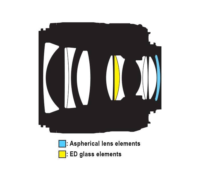

For example, Canon makes the EF-S 24mm f/2.8 for APS-C and the EF 24mm f/2.8 IS USM for full frame. Nikon makes the AF-S 35mm f/1.8G DX for APS-C and the AF-S 35mm f/1.8G ED for full frame. I've attached the lens construction images.
How can the lens designer keep the same focal length and aperture but modify the image circle?
Increase/decrease the diameter of the field stop, if possible.
The field of view and image circle diameter are related through the focal length, so keeping the focal length constant gives a trade-off between image circle diameter and angular field of view. I think the only option is the scale the diameter of the optic. Consider this lens (an extreme example):
https://www.badgergraphic.com/index...5&tag=Schneider+Fine+Art+Lens+XXL+1100mm/22.0
The image circle is 1 meter in diameter, the field of view is 45 degrees: for large-format photography, this lens is a 'normal lens'. If we keep the same focal length (1100mm) and look for a 35mm lens with those same specs, the field of view is much smaller (a couple of degrees or so). The 35mm lens also has a much smaller diameter (at f-stops identical to the XXL lens).
I suggest examining the design differences between a tilt-shift lens designed for 35mm format photography and a fixed lens with the same focal length as the tilt-shift lens. Tilt-shift lenses have image circles larger than fixed lenses to accommodate the movements, so you can see what is required.
