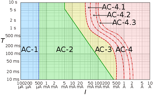

Current and time are what is plotted below. Consider an electrostatic shock as the OP mentioned. It has a very high voltage, but the shock only lasts a few microseconds (nanoseconds?), not long enough to be lethal.
https://en.wikipedia.org/wiki/Electric_shock said:
Log-log graph of the effect of alternating current I of duration Tpassing from left hand to feet as defined in IEC publication 60479-1.[19]
AC-1: imperceptible
AC-2: perceptible but no muscle reaction
AC-3: muscle contraction with reversible effects
AC-4: possible irreversible effects
AC-4.1: up to 5% probability of ventricular fibrillation
AC-4.2: 5-50% probability of fibrillation
AC-4.3: over 50% probability of fibrillation
For DC, the same article says.
The current may, if it is high enough and is delivered at sufficient voltage, cause tissue damage or fibrillation which can cause cardiac arrest; more than 30 mA[6] of AC (rms, 60 Hz) or 300 – 500 mA of DC at high voltage can cause fibrillation.
@anorlunda: so it's not actually the current (meant as rate of electron transfer, Q/t) but rather the amount of electrons itself, Q, that can be lethal? Because from that graph I see that 60 mA (danger current) corresponds to AC-4 only at 1s.
Therefore a spark from static electricity, even with a I = 25 kV/100 kΩ = 250 mA would not be lethal because for t < 20 ms it would fall under the green area AC-2 (Q < 0.005 C). This would also come into agreement with what berkeman said, because if the capacitance of the body is only 100 pF, then even if I have accumulated 25 kV, I can only carry 2.5⋅10-7 C and that is the amount I can discharge at 250 mA (so t = 1 μs).
Did I get it right?

Current times time has the units of charge, correct. What I meant is that it is wrong to think the biological effects are linearly proportional to any electrical quantity. Biology is highly nonlinear.

There is a wide range of conditions where the green curve agrees with the simple rule that it's the charge that counts.
Do you mean the green straight line segment? That's not lethal. Constant charge would make a hyperbola on an I versus t plot.
The scale is log/log and it looks to me that an increase of a factor of 10 corresponds to a decrease of about a factor of ten. So the threshold is pretty much based on total charge - I think.
my mistske, I missed the log-log.
But I think that it is a dangerous concept to publish on a public forum that a trivial calculation of charge is all that is necessary to determine safety. We should always refer laymen to safety codes and discourage them from attempting their own calculations.
