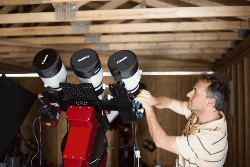

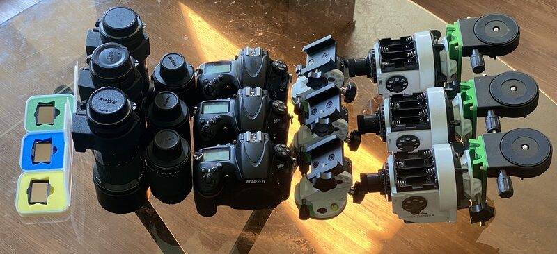

The 300mm lens is f/4.5 & adding a 2x teleconverter makes it 600mm f/9.
My goal is to get full Hubble palette data on a target in a single night.
With 1 camera we’re talking 30-45 minutes setup. Each exposure is in the neighborhood of 5 minutes so if I want 60 images to stack from 1 narrowband filter we’re talking 5 hours or 6 hours including camera setup. Multiply 6 hours times 3 filters and we’re talking 18 hours which is obviously too long for 1 night of imaging… & honestly I start getting pretty bored and tired after only around 3 hours.
But if I have 3 cameras going simultaneously, I could get 15 hours of data in only 5 hours, for example, which is doable in a single evening.
If I were to have to find 3 separate nights with appropriate moon/weather that also fit my will/determination and schedule it could take weeks or months.
So I’d basically be spending around $500x2 for the dslr bodies, $500x2 for the trackers, maybe $500x2 for the lenses + teleconverters, so I’m basically looking at spending around $3k in order speed up the process of acquiring a single Hubble palette image from weeks or months to a single eve.
Alternatively I could capture 3 targets in the time it currently takes to capture 1 target.
Three cameras on a single mount would require an expensive mount. I could get 2 more trackers for about $1k ($500 each) but I am already basically pushing the weight limit for a single tracker.

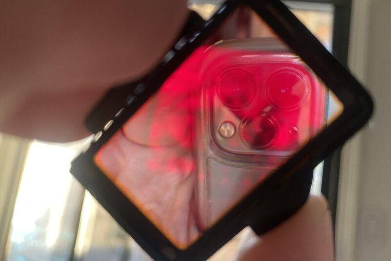

Here’s what you could expect from a clip-in narrowband Ha filter:
Devin-M said:
Heart Nebula - IC 1805 - Sharpless 2-190 - 7500 light years
45 minute exposure - 9 x 5min - 6400iso - 600mm f/9 - Moonless Bortle 2 (3/3/21)
Nikon focal 300mm f/4.5 + Nikon TC-301 2x teleconverter
Nikon D800 w/ Star Adventurer 2i Equatorial Mount
Astronomik Narrow Band (6nm) Hydrogen Alpha Filter For Nikon Full Frame DSLR

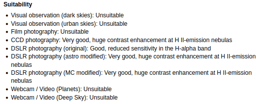

  • #83
From your link:
This is probably my next purchase when I re-open my wallet!
  • #84

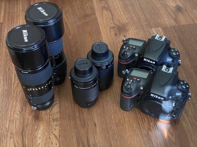

I just ordered 2 more d800 dslr bodies, 2 more 300mm lenses, 2 more 2x teleconverters, and 2 more star trackers to use with my 3 narrowband filters so hopefully next time I venture out I’ll be getting full Hubble palette data in a single night… I do wonder if I have 3 cameras with 600mm f/9 going simultaneously, what is the effective f ratio?
  • #90
Because you have thrown away, effectively, about two thirds of the light entering each camera because of the filters, you are back where you started. With narrower band filters, you are losing even more light; people need long exposures to reveal the low levels of Hydrogen lines in some DSOs. The pictures are pretty and impressive but not 'reality'.
I look forward to hearing the results of your unusual approach.
