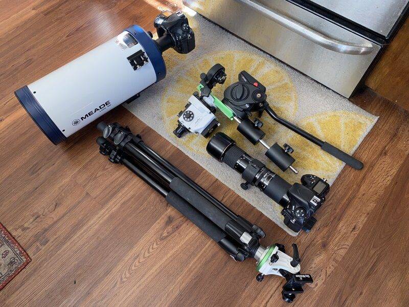

OTA’s received. They’re in better condition than my original rig… :oldbiggrin:

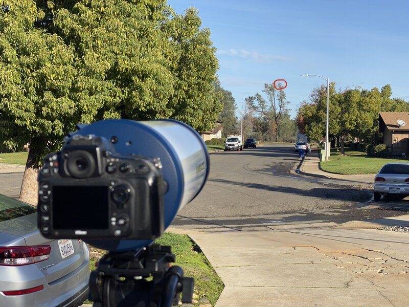

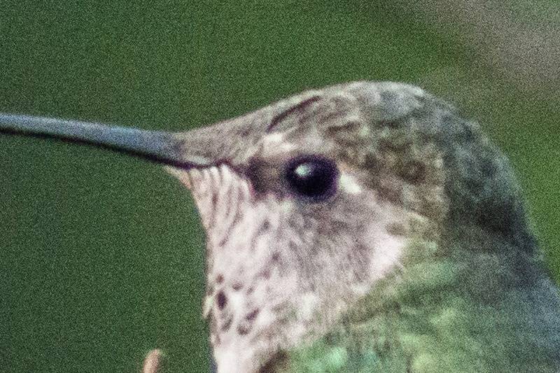

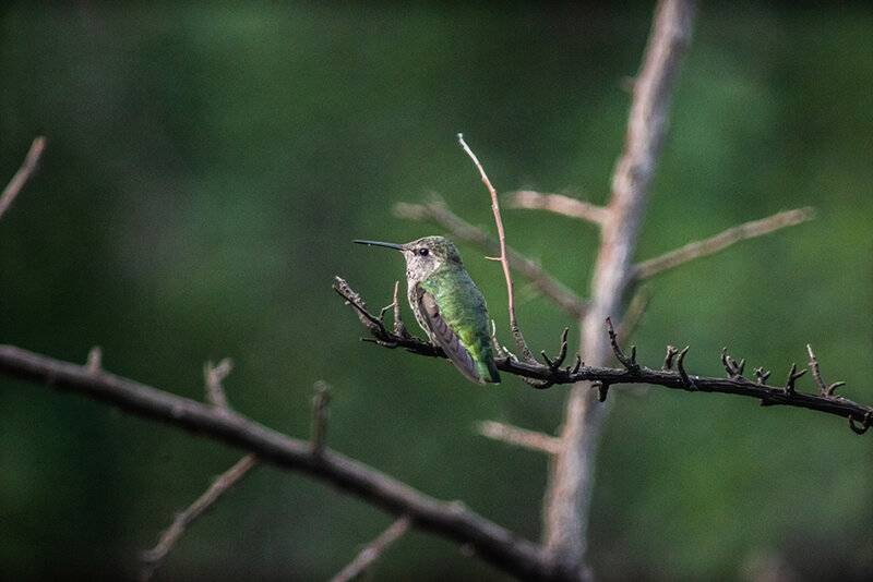

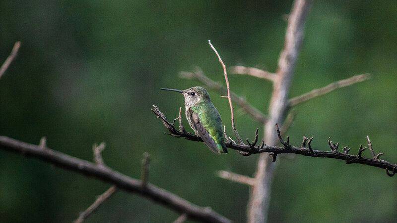

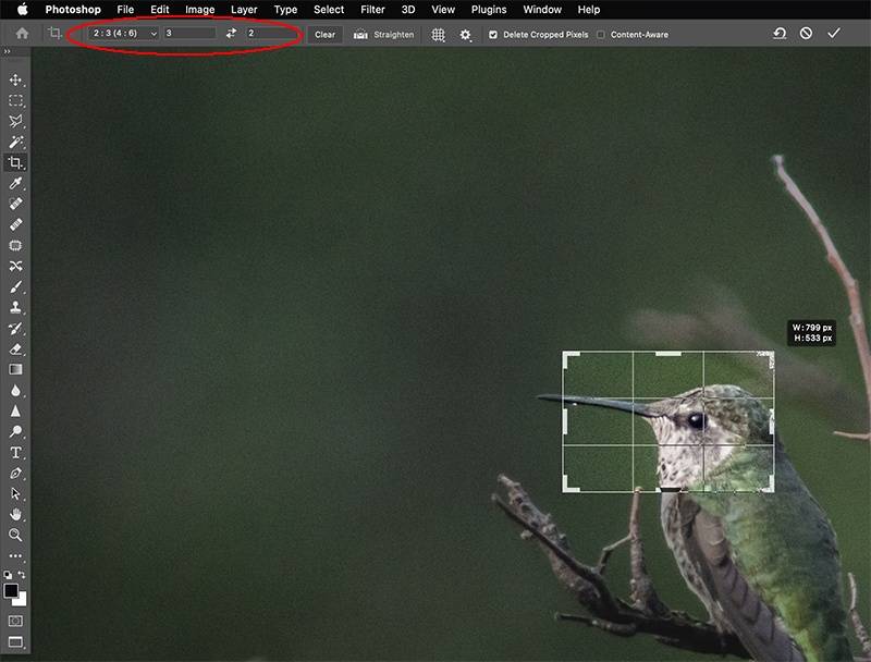

quick test shot with the new optics while I'm waiting for the new equatorial mounts...
"anna's hummingbird" - 1/2500th sec, 6400iso, 600mm, f/9, 100% crop
https://www.speakev.com/attachments/img-4433-gif.150742/
https://www.speakev.com/attachments/img-4434-gif.150739/

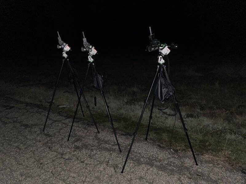

the “goldman narrowband array” is nearly complete… astronomik narrowband hydrogen, sulphur & oxygen 6nm clip-in filters, 300mm lenses, 2x teleconverters, d800 dslrs, star adventurer 2i equatorial mounts, still just waiting on a couple tripods and intervalometers…

Yikes. Is there an adapter that can fit a monochrome atsronomy camera to DSLR lenses directly? Three of them with your filters in them can probably do this job cheaper?
Edit:
Looks like it exists: (you still need 3 trackers, that's next one to address :oldbiggrin:)

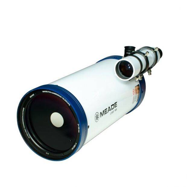

I found this. An expensive mount, if I'm not mistaken.
See here.

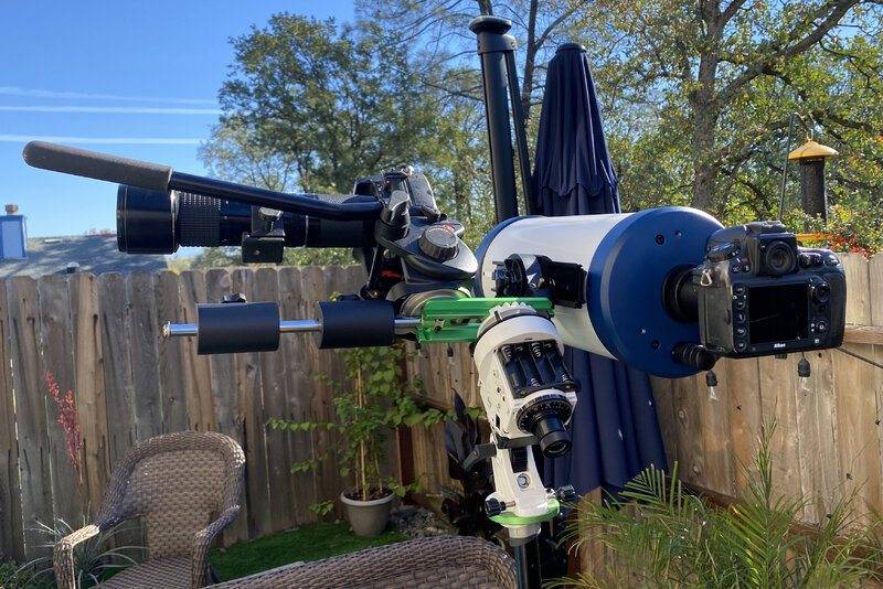

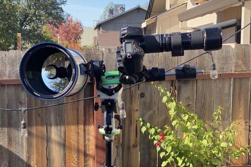

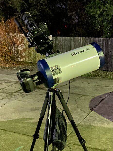

At least with the Star Adventurer 2i setup polar aligned and balanced as pictured below, I think they will be significantly out of balance in most cases, even if you have them pointing at the same target. Suppose both cameras are “front heavy” on the mounting points due to the lenses. Suppose you want to aim to a target somewhat to the left of the North Star from the initial position. When you point the camera on the left towards the left, the heavy lens will be further from the fulcrum and the lens on the right will be closer to the fulcrum. The camera on the left will pull downwards with greater force ie out of balance. You can slide the central dovetail to compensate but it will be a huge hassle, and the ball joints can also slowly slip especially with heavy cameras mounted sideways.
