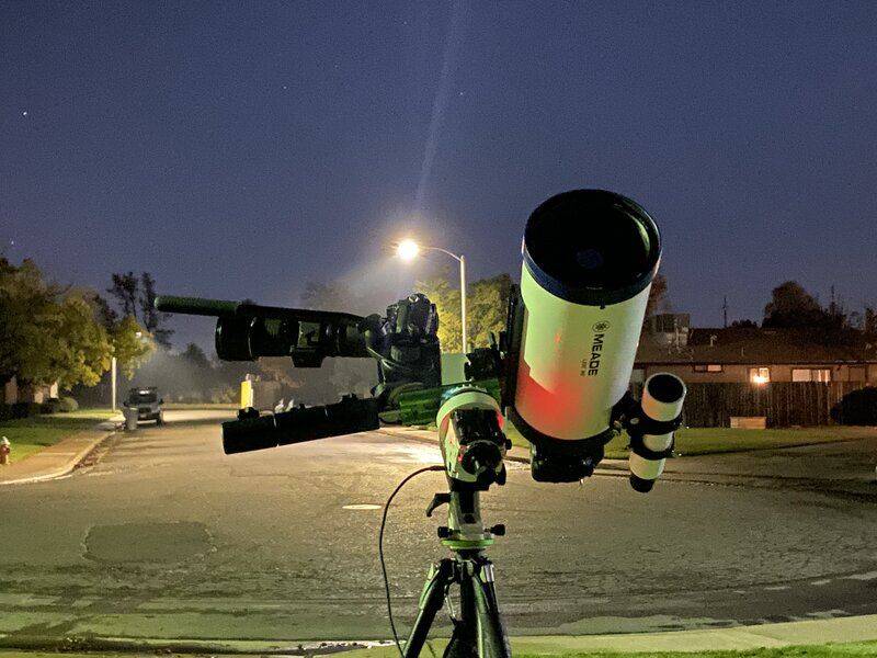

  • #121

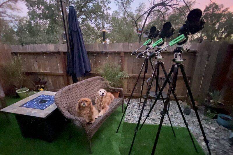

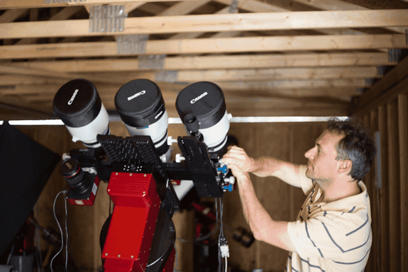

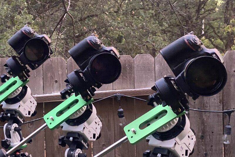

I present to you…
“…the goldman array…”

  • #122
Devin-M said:
I present to you…
Waiting for the first light from this! Are all 3 stock?
Devin-M said:
The Star Adventurer 2i (currently $425) actually allows for 2 cameras if you add a separately sold ball head.
That's great. Though I understood there could be some issues.
I see a lot of people compositing images over multiple nights. Have you tried it? Will imaging 3 narrowbands over 3 different nights work?

It’s too cloudy the next 2 days and after that the moon will be up for the following 2 weeks so it will be that long before I test. I’ve found it isn’t worth trying to shoot when the moon is up. If you’re in a bortle 2 & the moon is up you’re basically in a bortle 7 at that point.
Yes you can composite from a single camera over multiple nights, I just won’t have patience for that.

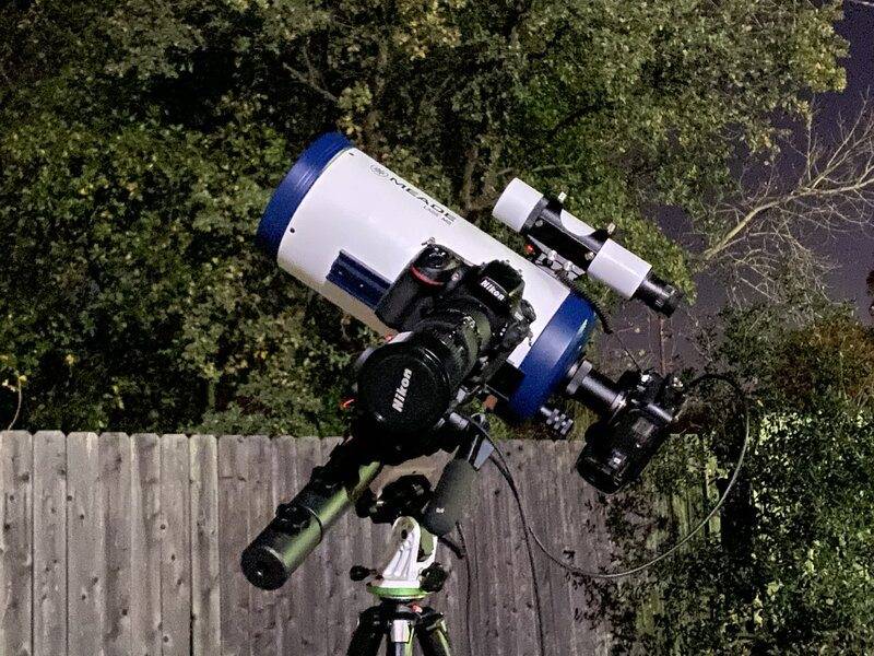

PhysicoRaj said:
Are all 3 stock?
They are all stock Sky Watcher Star Adventurer 2i Pro Pack mounts but I have macro focusing rails in between each camera and mount so I can balance each camera on the declination axis which is important because otherwise it will become out of balance on the motorized right ascension axis when you swivel to the target from the initially balanced position.
https://optcorp.com/products/sky-wa...GD81VmjiJTU9j1-8wL9nUM70nGhUxT5BoClI0QAvD_BwE

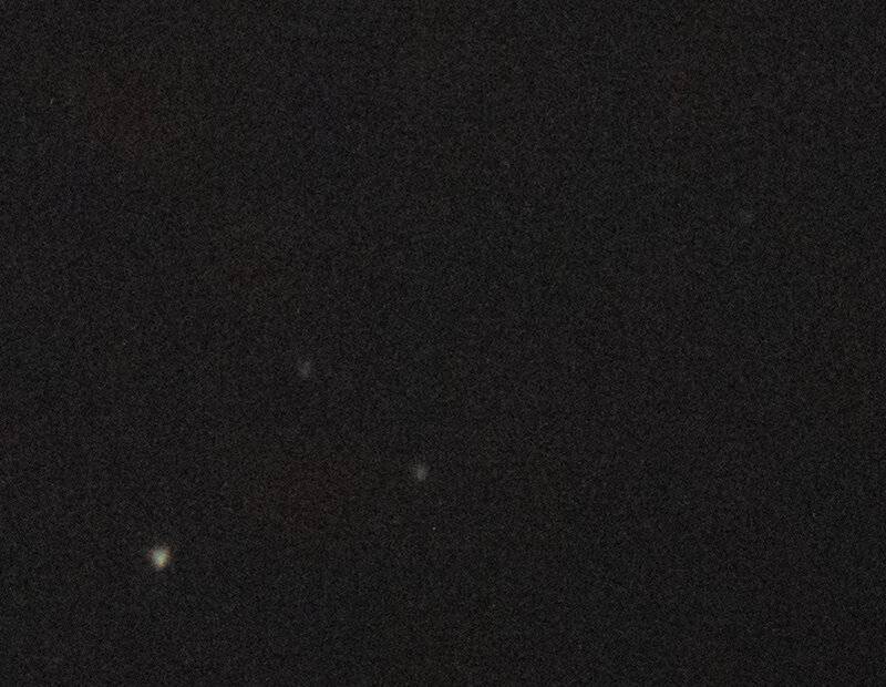

On second thought, maybe I’ll have a go tomorrow night. Should be clear and the moon will be down after 9pm onwards.
I took these a couple of nights ago with some handheld 10 second exposures on an iPhone…

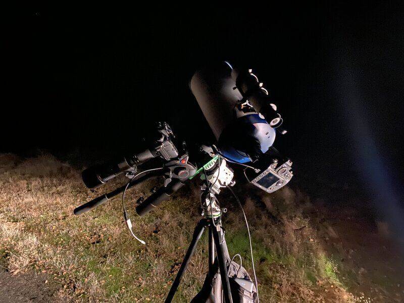

I think tonight went well. I got RGB as well as narrowband Hydrogen, Oxygen and Sulfur data of an emission nebula at 600mm f/9 with 3 cameras running concurrently in a single session. I was on site at about 7:45pm had all 3 narrowband cameras up and running by around 11:30p and let them run until 3am, so that’s over 9 hours of narrowband data in just over 3 hours. I set up one camera with no narrowband filter first to capture rgb, and once this was up and running I got the 2 other cameras capturing narrowband. Once those two were up and running I reconfigured the RGB camera for Hydrogen Alpha and as I mentioned from 11:30p til 3am all 3 cameras were capturing narrowband. I left the cameras running dark frames on the way home and will continue to let the cameras capture more dark frames while I sleep. The settings I chose were pretty extreme on the narrowband… 10 minutes per exposure at 6400iso for the hydrogen and oxygen filters and a full 20 minutes of open shutter per exposure on the sulphur filter. Haven’t had a chance to look at the data but I do know they were in pretty decent focus as I used a bahtinov mask to focus every camera, and again after switching from RGB to Ha. The most troublesome thing that happened was I had very slow internet on my phone for plate solving to confirm aim. Also one of my USB batteries powering the mounts kept shutting off so I ended up running 2 mounts off a single USB battery pack (fortunately it had 2 output ports). Also next time I’ll remember to switch camera batteries when switching from RGB to Ha as I think the Ha session may have ended a little early from the camera battery running out of juice at some point. All in all I deem the mission a success (having not yet seen the actual data). Will begin processing data tomorrow…
You have some serious steady hands... And btw 10s exposure in a little light pollution makes night look like day! I see why NB is the way to pursue this hobby in difficult skies. But there's no solution for clouds :(

Was asking about the DSLRs - two others you bought. Isn't a full spectrum modified camera going to give amazing results for Hubble palette?
  • #130
All 3 DSLR’s are standard unmodified D800’s. I don’t have any experience with the modified cameras except clipping in narrowband filters.
I ended up with about 48x 60s RGB shots (2880s) @ 3200iso 600mm f/9, 19x 600s Ha shots (11400s) @ 6400iso, 28x 600s OIII shots (16800s) @ 6400iso and I think around 10x 1200s SII shots (12000s) @ 6400iso or about 12 hours of data total. I was physically there for about 7 hours and did about 4 hours of work in one chunk at the beginning of the session.

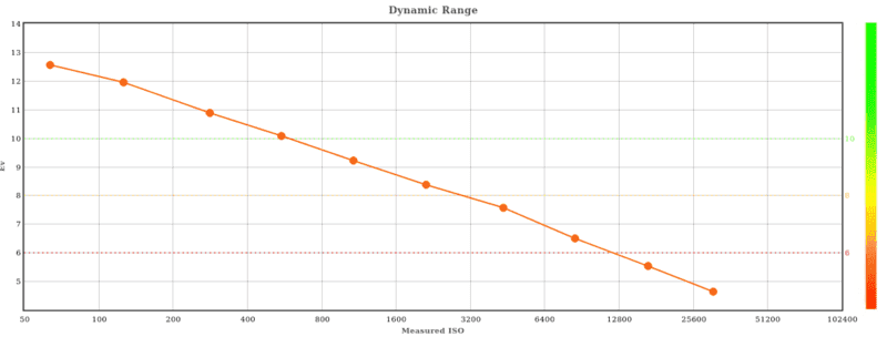

The other one is quality settings on your camera. Obviously you'll want to be shooting in RAW mode... but if you're doing plate solving through your phone and you have slow internet in the middle of nowhere, you don't want to be fiddling around with RAW files, so at least on my camera I set it up to record both the RAW file and a "small" size jpg (there's also medium and large). So instead of trying to fiddle around with converting and uploading a raw file on your phone, you transfer the small JPG and use that for plate solving ( http://nova.astrometry.net/upload ) while you also retain the RAW file for later processing.
Good point.

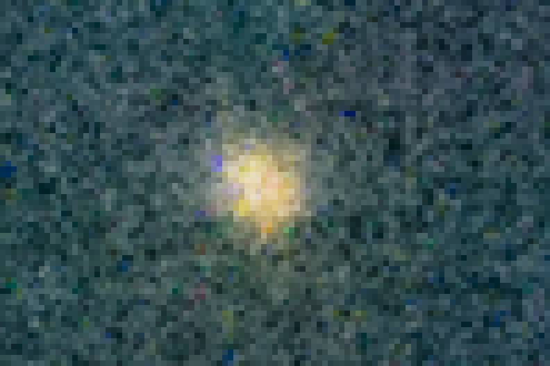

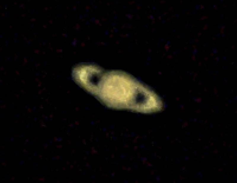

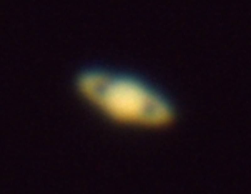

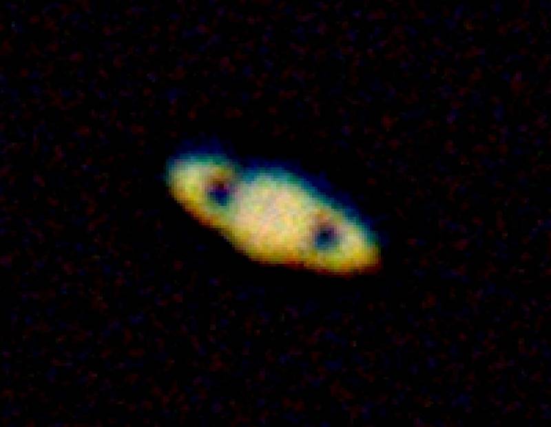

Caught some signal from Saturn. I definitely can improve over this, because this is my first planetary image and there was a layer of clouds / haze that I shot through, which will have certainly pushed the quality down. I believe I can get the gap between the rings and the planet clearly next time.
  • #141
Planetary images are best with very long lenses (2,000mm) to fill more of the sensor.
  • #142
This one was at 2100mm, but the sensor is a DSLR which is bigger than the planetary webcams so the size of the planet relative to the frame is small.
Also, the lens and Barlow quality is not that great, so the rings are not clear. I will probably move to a used bigger scope and better optics, I'm just fiddling around with the present one till I save up some bucks. At least I was able to partially resolve the rings, let's see how much juice I can extract from this scope while I'm at it.
Edit: BTW, do you think looking at the image that my barlow is actually 3x?
Image size: 1920x1080 (3.7 micron pixel)
Cropped to: 1000x1000
Objective FL: 700mm
Barlow: 3x (?)
I have seen some images of Saturn at 2000mm like this and it is much larger. Even though that image is 1280x720, the proportion by which the planet is bigger than mine seems to indicate that my Barlow could be a 2x.

The rule is “Spend spend spend” I’m afraid.
  • #144
It is rather scary. But now I am starting to believe that Celestron might have kind of duped me with this scope. Check the edit on my last post.
Even without a barow, my aperture seems to have a dawes limit resolution that is larger than what the focal length can extract. On top of it they gave a Barlow which seems ridiculous unless my math is wrong.
Objective FL: 700mm
Barlow: 3x (?)

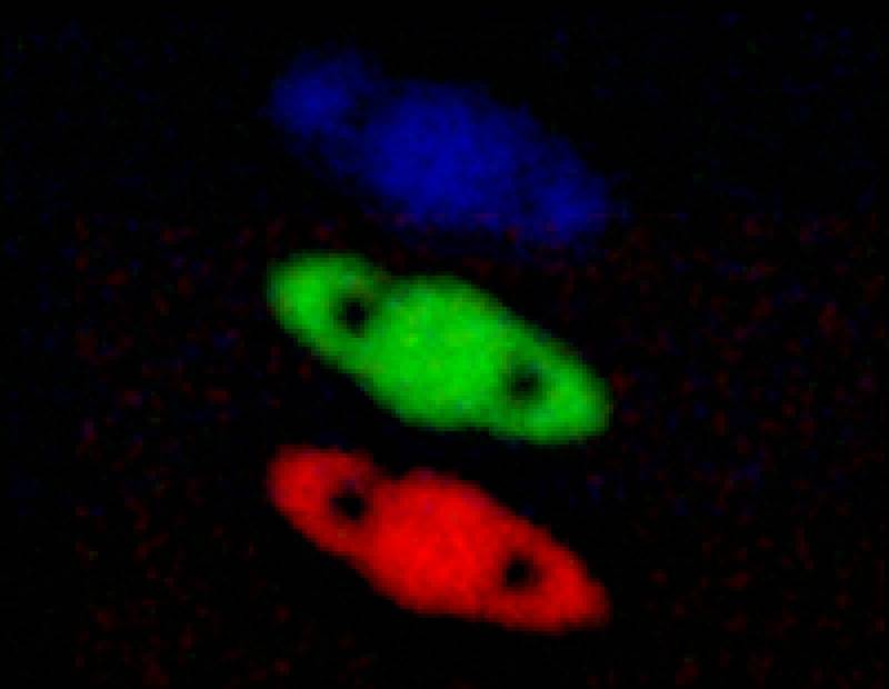

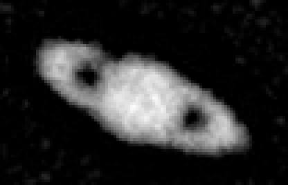

In my earlier test shot of Saturn which appeared to have similar detail, I was shooting at 1/3.5 the focal length (600mm f/9), but the imaging sensor on the D800 was 7360x4912… 3.8x the sensor resolution… The following shot (which I posted before) has been cropped & also upscaled with interpolation.
https://www.speakev.com/attachments/saturn_stacked_mono_green2-gif.150147/
If you crop the image before uploading it, the planet will have a larger final display size on the web page without sacrificing resolution. This website is downsizing your final image to below 1920x1080 when you upload it to conserve bandwidth.
For best final display you’ll want to determine what size this website downsizes your final image to, and then do a 100% crop at those same dimensions before you upload it.
You could also host the image elsewhere and include a link to it to avoid the final downsizing that occurs after you upload it.
  • #146
Devin-M said:
In my earlier test shot of Saturn which appeared to have similar detail, I was shooting at 1/3.5 the focal length (600mm f/9), but the imaging sensor on the D800 was 7360x4912… 3.8x the sensor resolution… The following shot (which I posted before) has not only been cropped but also upscaled with interpolation...
I have cropped a bit - just checked that the image I have uploaded is 1000x1000. Note that I am not worried about planet resolution, but the size of the planet in relation to the frame size. But me cropping it should only give an even bigger planet. And your frame size being 3.8x the size of mine before cropping, and 3.5 times lower focal length, I should have definitely gotten a bigger relative size of the planet. Something definitely seems off.
  • #147
I think it’s as simple as cropping out the empty space around the planet before uploading and what remains will be displayed at a larger apparent size.
  • #148
Doesn’t your camera shoot in RAW mode higher than 1920x1080?

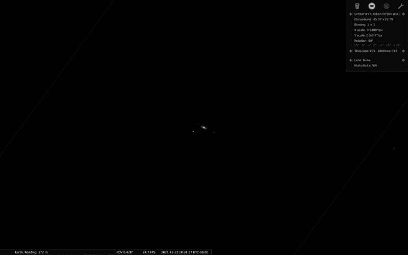

  • #149
I’m not sure this is all accurate… we haven’t factored the different sensor size… I was using a 35mm sensor.
  • #150
I use a crop sensor, 1.6x. Now the more cropped it is the bigger my planet has to be, so I'm even more suspicious now.
It does, but the FPS is low. I use a lower size to get more FPS.
