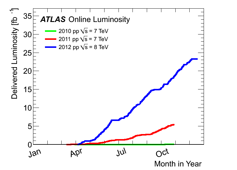

For some interesting plots showing the data collection over time (which tells you something about when the machine was running) you can check out some of the ATLAS public data (I'm sure CMS have something similar too) https://twiki.cern.ch/twiki/bin/vie...tyPublicResults#Multiple_Year_Collision_Plots
This one in particular shows you how much of each year they were running for. The integrated luminosity is a measure of how many collisions have occurred up to that point. Where the graph goes flat basically means that the LHC beams were turned off for maintenance. You see that each year the machine was running most of the time between early March and late October, but also kept going through to December in 2012.
