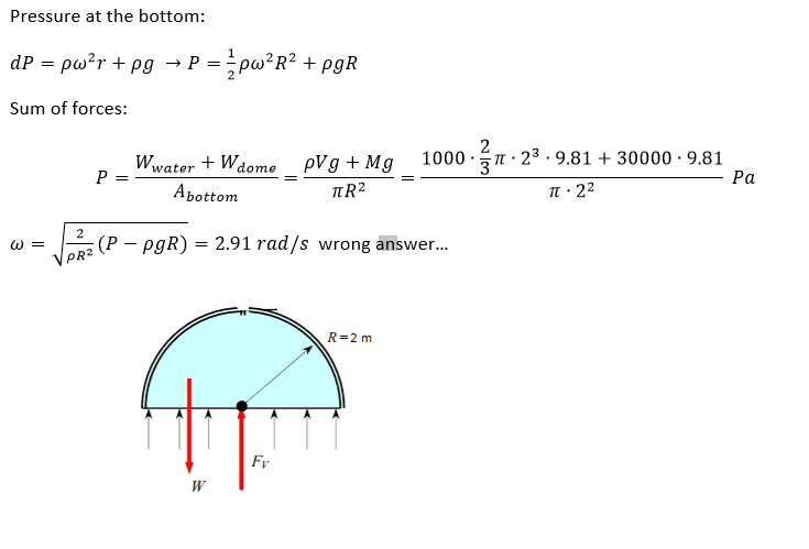

A hemispherical dome filled with water, radius 2 m and weight 30 tons, can be lifted by giving it a constant angular velocity around its vertical line of symmetry. The dome has a hole on the top. Decide the minimum angular velocity.
My answer is 2.91 rad/s .
The correct answer is 1.95 rad/s.
Shown in the attached picture.
I don't understand this problem . Angular velocity of what ? How does whatever it is act on the hemisphere to lift it ??

I'm sorry, I have tried to make the problem clearer now :)
How does rotating something cause translation? Sounds like a breach of conservation of momentum?
Edit: So the water isn't lifted, just the hemisphere?
