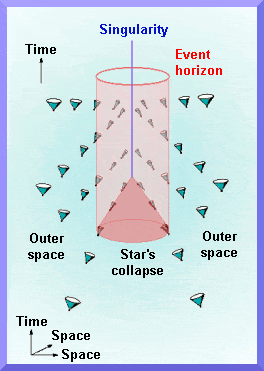

I searched a lot but I am not sure if I understood correctly the change in the shape of light cone while speeding up. I am aware that the x and ct axis are getting closer to each other like scissors while you speed up as the graph below shows, both symmetricaly approaching the ct=x or v=c line.
But I am not sure if there is a corresponding graph that shows the shape of the light cone.
I have found the following cases.

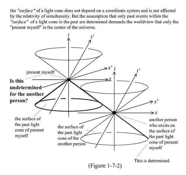

1. Stays the same, keeping its shape, its angle (45o), its circularity.

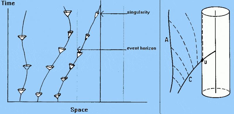

2. Its direction is now parallel to ct' axis, it keeps the circularity, its symmetrical shape is now round ct' axis and not ct, its opening angle closes and equals the angular difference between ct' and ct=x line (light cone boundaries), until it goes zero when v=c. Then the light cone is just a line.
Unfortunately most shapes are from black hole cases, but as I recall gravity is the same as acceleration. Here also rises the question how the light cone also changes in constant speed with no acceleration.

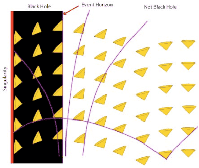

3. It keeps its upward direction but it loses its symmetrical shape round ct axis. Maybe the slice of the future that was a circle with center the axis ct, is now an elipse with two centers, ct axis and ct' axis. The rather radical about this light cone is that it overpasses the initial light cone boundaries and goes under the line ct=x (or v=c). This seems to violate GR rules. In this diagram while in the same direction we go below ct=x, in the opposite we keep ct=-x the boundary.
4. It keeps its symmetrical round shape with the same angle but now round ct' axis. Maybe the slice of the future (perpendicular to ct' now) remains a circle but with center the axis ct'. The rather radical also about this light cone is that it overpasses the initial light cone boundaries and goes under the line ct=x (or v=c). This seems to violate GR rules. In this diagram while in the same direction we go below ct=x, in the opposite we don't keep ct=-x as boundary instead we follow the same angle as ct' to old ct.
As I said I am aware that all the above graphs are not exactly the same but with the equivalense of gravity and acceleration and the "hypothetical" invariance of lightcone representation they should in a way (if not exactly) agree in principle.
To the extent that these different "cases" are even valid (see below), they refer to different physical spacetimes, only one of which (the first one) corresponds to the diagram you give of how the ct-x axes change under a Lorentz transformation. That's because if you're doing a Lorentz transformation, you've already assumed that you're working in Minkowski spacetime (the flat spacetime of SR), in which the light cone behavior is as you describe it in case #1. In other spacetimes (such as black hole spacetimes), there is no such thing as a Lorentz transformation covering all of the spacetime, so the ct-x axis diagram you give doesn't even apply.
No, it isn't. The correct statement of the equivalence principle is that, locally (the qualifier is key--see below), being at rest inside an accelerating spaceship is the same as being at rest in a gravitational field (provided the acceleration you feel is the same in both cases). But "gravity" is much more than just being at rest in a gravitational field, and the equivalence is only local anyway--it doesn't extend through all of spacetime, so it doesn't help you in trying to understand something global like how the light cones behave.
The reason the light cone behavior, globally, is different in black hole cases is that spacetime is curved, not flat. Also, the light cone behavior you are talking about in the black hole case (as shown in the diagrams you give) is a change in the light cones as you move from one location to another in spacetime. That's not the same as how (if at all) the appearance of the light cones in a spacetime diagram is affected when you do a Lorentz transformation at a particular event, which is what the start of your post is talking about. So you're confusing two different things.

The Count said:
As I understood the correct answer is 1.
For the case of flat spacetime, yes. But a black hole spacetime is not flat spacetime; that's why the other graphs look different.
The Count said:
You mean there is no diagram ct-x that applies
There are coordinate charts that apply to black holes--the other images you gave are based on different coordinate charts that apply to black holes. But thinking of them as "ct-x" diagrams is probably not a good idea. Some of the charts (such as the first one under your item 2) don't even have timelike coordinates, so there is no analogue to "ct" in them.

The Count said:
in case 4. the grad of the light cone overpasses 45o. This is wrong, isn't it?
No.
The Count said:
The correct graph for black holes is case 2. correct?
They are all correct; they are different coordinate charts on the same spacetime.

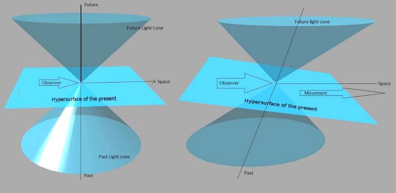

PeterDonis said:
a Lorentz transformation does not change their shape at all.
So if I understood correctly no matter the tilt of the two axis (x,ct) while in high speed (but no acceleration) the lightcone does not change at all it's shape. Isn't the speed determined by the angle to the ct axis? When the ct axis tilts towards the +x section of x axis, then it seems that to get close to the lightcone line of the -x section, the angle is going to be more than 45o (from the tilted ct axis). This means that it passes over the limit of c, or do the maths change?
But when we have acceleration the light cone changes! The question is how it is changed? It tilts until it "falls" on the +x section of x-axis (case 4), it closes and tilts at the same time until it ends up in a line (case 2), or it tilts and inflates at the same time (case 3). What I am looking for is a diagram (like the first graph) that shows the change of the lightcone when in acceleration. I have not found it no matter how much I searched.
I would not say that the light cone changes. I would say that the coordinates change. However, it is correct that the coordinate expression for the light cone is different in non inertial coordinates than in inertial coordinates.
Yes. And as that angle approaches 45 degrees, the speed approaches the speed of light. The angle can never reach or cross 45 degrees (i.e., it can never reach or cross the light cone), because nothing material can move at or faster than the speed of light.
No, it doesn't. You can't change the geometry of spacetime by changing your state of motion. The light cones are part of the geometry of spacetime. (Note that this is true not just for accelerated motion in flat spacetime, but for any kind of motion in curved spacetime, i.e., when gravity is present. See further comments below.)
