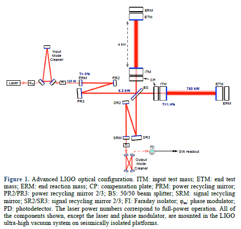

Even if you only consider one arm of LIGO, that arm does not have two test masses in it; it only has one, at one end of the arm, and the laser/detector at the other. Since you keep on bringing up diagrams and videos of LIGO, it is going to be a lot easier if you talk about LIGO's actual configuration.
Good idea. The first attached image is the actual layout from page 3 of http://arxiv.org/abs/1411.4547:
As you can see, there are two mirrors or 'test masses' labelled ITM and ETM in each arm. The light bounces between the ITM and ETM approximately 280 times (that's an average of course, a small fraction of the photons get through on each pass). A displacement of the ITM towards the ETM by dx reduces the path length within the cavity by 560dx but only increases the path from the beamsplitter to the ITM by 2dx (once on input and once on output). Relative to a fiducial point in the middle, the ETM would move by -dx which also reduces the path length by 560dx. Overall, for displacements of each by dx and -dx, the optical path length changes by 2*560-2 = 1118dx. Obviously that is dominated by the change within the 4km cavity between the ITM and ETM. Ignoring the short distance from the beam splitter to the ITM (tens of metres at most) only introduces a small scaling error, much less than 0.1%. In other words, LIGO measures the length of the two cavities which are shown in the diagram as "4km" long and containing laser at a power level of "750kW".

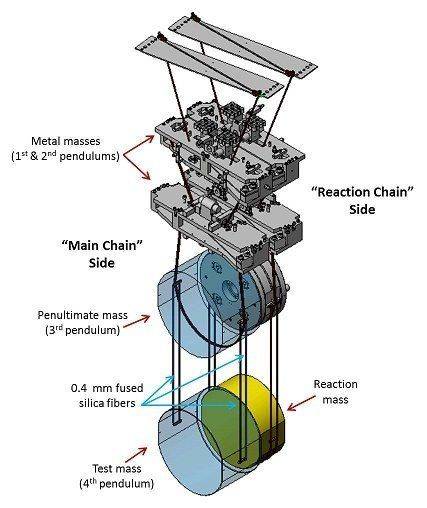

The second image shows the suspension system typical of one of the four ITM and ETM mirrors. As you can see, there is nothing to stop their motion along the beam direction for either mirror so taking a fiduial point in the centre of the tube is reasonable IMHO. Of course the location we choose cancels out in the calculations anyway so it is a moot point.

  • Schematic of the Advanced LIGO optical configuration showing a laser, input mode cleaner, power recycling mirrors, beam splitter, two 4 km arms with ITM and ETM test masses, signal recycling mirrors, and photodetector with GW readout.

  • Exploded 3D CAD drawing of a LIGO suspension: metal masses for the 1st and 2nd pendulums at top, a penultimate mass, and a test mass with reaction mass hung on fused silica fibers, labelled Main Chain and Reaction Chain sides.
The fiducial point for the LIGO apparatus is at the corner of the "L" (the beam splitter). It is not in the middle of either arm. If you want to analyze the actual signal output by LIGO, that is the fiducial point you need to use. If you analyze with respect to a fiducial point in the middle of an arm, you will not be analyzing the same signal that LIGO outputs.
GeorgeDishman said:
A major part of my confusion is how we deal with the stresses in what was called the "Earth frame" earlier in the thread
The paper you linked to makes it clear that all of the key components of the LIGO detector are free to move in the "detector plane" (the plane defined by both arms, considered as two intersecting lines--we can think of this plane as being "horizontal", perpendicular to the local direction of "gravity"). So none of the components will be stressed in that plane. (The tunnel walls will be, but they play no role in determining the signal LIGO outputs.) There will obviously be stresses perpendicular to that plane, but those should not affect motion in that plane. I believe this is the basic argument used by the LIGO team to justify ignoring stresses when analyzing the signal (though of course they have to account for those stresses in the complicated apparatus that tries to keep all of the key components in the same plane and isolate them from outside disturbances).
If you understand why the mirror on the ITM is present, it should be clear that it is the length of the Fabry-Perot cavity that is measured, not the distance to the corner of the L. In addition, the signal (i.e. the phase difference at the photodetector) should not depend on the choice of the fiducial point (or the point wouldn't be "fiducial" in the way I understand the word).
However, what you are missing is that I don't "want to analyze the actual signal output by LIGO", I want to produce a visualisation of the gravitational waves to which it is responding.
Right, so if you imagine a wave propagating in the direction perpendicular to the detector plane (i.e. vertical) and such that the orbital plane just happens to align with one arm, then you get the toy model I've been describing. We can consider the distortion that the GW would consider in that orientation. Then, for any realistic situation, the actual wave will have components of both plus and cross polarisation and that combination will need to be projected onto the orientation of the detector arms to take account of the effect of the suspension.
More precisely, because of the "magnification" effect of the cavity, the contribution to the overall distance measurement of the distance from the ITM to the beam splitter is very small (a fraction of a percent). That is because the length of the cavity is magnified by a factor of 1000 or so while the ITM-beam splitter distance is not.
It does for the LIGO team's analysis because their "fiducial" point is part of the overall construction of the coordinate chart they are using. It is true that, in principle, any choice of chart should give the same values for actual observables like the interference pattern at the photodetector, so in that sense the choice of fiducial point doesn't matter.
Exactly.
Thank you.
