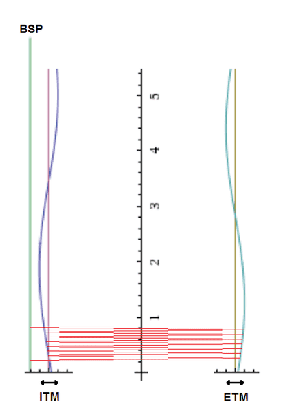

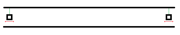

I'd like to start from what I think is the right way to look at this and then take it forward to explain a problem I have and see if someone can straighten out my thinking.
pervect said:
I think that possibly you do not realize that the mirrors on Ligo are attached to test masses that are basically "hung from strings", so that the test masses, and the attached mirrors, are free to move?
We'll call the thing that the test masses are suspended from "the frame".
I think that may be confusing as later posts talk about the "LIGO frame" as a "tangent four-space" which is somewhat different, so I'd rather say the mirrors are suspended from the ends of the beam tubes (but there's nothing in name).
https://www.ligo.caltech.edu/image/ligo20150519c
What I would like to visualise is that we place a ruler under each mirror with the zero point directly under the suspension. The 'string' holds the mirror from a point on the top of the tube, the ruler is bolted mounted horizontally and supported on a pillar directly under the same point. "Motion" of each mirror can then be considered relative to its adjacent ruler.
Everyone agrees that the test masses move relative to the frame.
That's not entirely true. I have seen a PhD paper where the statement was made that "the proper length between the mirrors varies but not the coordinate length" and therefore that the mirrors would not move relative to their adjacent rulers at the tube ends, and the support mechanism is only there to isolate them from seismic noise. However, it seems to me that if that were the case, the so-called "sticky bead argument" would fail as it would no longer be possible to extract energy from a GW.
https://en.wikipedia.org/wiki/Sticky_bead_argument
This frame is of no particular interest to the way the Ligo experiment works, so little effort is spent explaining what happens to it. If one did measure what happened to the frame , it wouldn't change measuarbly in length. The test masses, that are perfectly free to move at the slightest influence, require our most sensitive insturments to measure their motion. The frame moves even less.
Actually, understanding the behaviour of the frame is crucial to what I'm trying to do so I want to come back to this later but I need to explain the background first.
The viewpoint that needs expanding space is a viewpoint that is attached, not to the frame, but to the suspended test masses. One can regard each test mass as having a constant coordinate, a coordinate that does not change with time. In this view, there are no external forces acting on these test masses, so one regards them as not moving. When the gravity wave passes by these test masses, changing their separation, but one ascribes this change in distance to "expanding and contracting space", rather than to any real force. There is no real force according to this viewpoint, the test masses are regarded isolated from any non-gravitaitonal forces, and gravity is not regarded as a real force (according to this viewpoint, which is different from the Newtonian one). One might say that the test masses are in a state of "natural motion", like a body at rest in Newtonian physics.
OK.
In this viewpoint, it's the frame that is "moving". Since the test masses are "standing still", i.e. have constant coordinates, and the frame is moving relative to the test masses, the frame must be "moving". The reason the frame moves is that internal forces generated by the interaction of the atoms that make up the frame keep the distance between atoms nearly constant. Internal forces due to the interaction of the atoms that keep the length constant (or nearly constant) are what causes the pieces of the frame to move in this viewpoint.
Surely, in order to get a detector output in this view, the motion of the mirrors must be in opposite directions so would the tube not need to stretch and shrink rather than moving as a whole? The time-varying length would still be ascribed to the atomic forces though.
This viewpoint of expanding space also occurs in cosmology, and there are similar issues of (mis)understanding the popularizations in cosmology as well.
Exactly.
While I understand this alternative view (and that they are equivalent), it will be easier for what I want to do to stick with the more common interpretation but what is important to me first is to confirm that the effect of a GW would be to make the mirrors move relative to their respective adjacent rulers which I think is an coordinate independent question. Am I OK so far?
