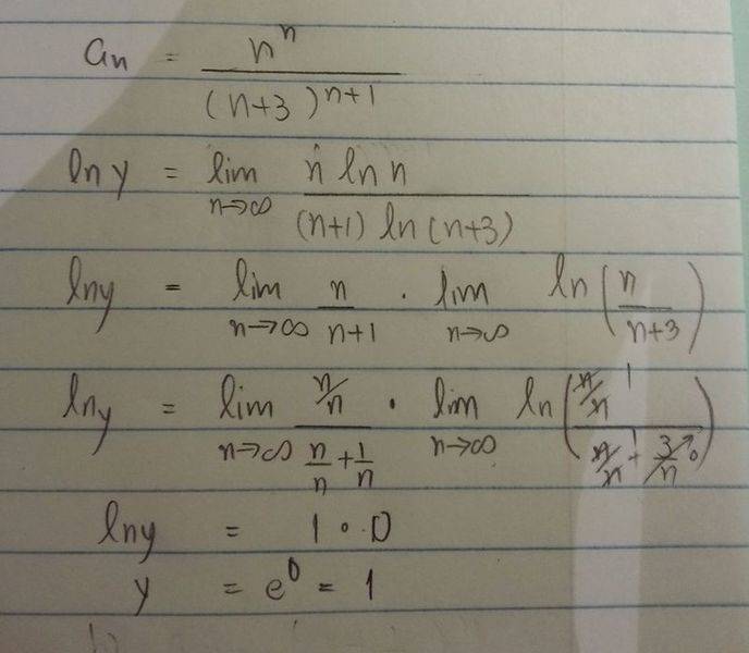

Find the limit of this sequence
An =[itex]\frac{n^{n}}{(n+3)^{n+1}}[/itex]
The answer is 0 but my answer is 1
thank you
Your first step is wrong.
[tex]\ln \frac{a}{b}≠\frac{\ln a}{\ln b}[/tex]
The correct property is:
[tex]\ln \frac{a}{b}= ln a-\ln b[/tex]
Anyways, instead of taking log on both the sides, you can factor out n from denominator.
Sorry I cannot see how n can factor out from denominator
like this ??
http://postimage.org/image/7cqb5oowp/ Thanks
What I actually meant was this:
[tex]\lim_{n→∞} \frac{1}{n+3} \left( \frac{1}{1+\frac{3}{n}} \right)^n[/tex]
