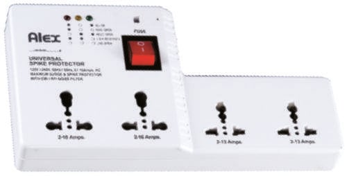

I have a spike guard that is showing line and neutral reversed. Those 2 Leds glow. This wasnt happening before the wiring was changed of the house.
Now when i connect a mobile charger(with 2 pins) then the mobile gets charged,
but when i connect a three pin hard drive power cord to it, then the hard disk doesn't work. Is there problem with the hard disk or the line n neutral reversed glow of spike guard is an indication of some other fault.
or is there fault in the spike guard?

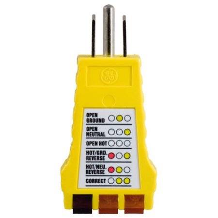

please invest in one of these, they're around $6US.
Use it to check your outlets. That'll tell you whether the spike-gard is telling truth.

A spike guard is a device for surge protection. It is an outlet strip with inbuilt surge protection and the spike guard also has indicator built just like Jim showed.
Sorry for the error, the spike guard is showing Line and Neutral reversed. It is working for 2 prong devices but when i plug 3 prong device in the spike guard, it is not working.
It was not showing this line n neutral reversed error before the house wiring was changed. By house wiring changed, i mean electrician came, n pulled out some wires n added new ones. a pianter had also come.
A three pin device works when plugged to an outlet, but when i plug it to the spike guard, the spike guard shows Line n neutral reversed n the three pin device doesn't work.
http://www.anchor-world.com/images/products/accessories/spikeguard/big/22568.jpg it is showing 3rd fault...

Can you get the uk equivalent of what Jim showed you in post #11?
Until we can get good readings on the socket to be sure the problem is or isn't before the spike guard, we can only guess.
If the socket is ok then the spike guard is probably defective. I know the timing of the problem appearing is strange, and I don't
like coincidences, but they do happen sometimes,
It looks like a uk version of a plug tester is about 3 pounds (I can't find the British pound symbol, sorry)

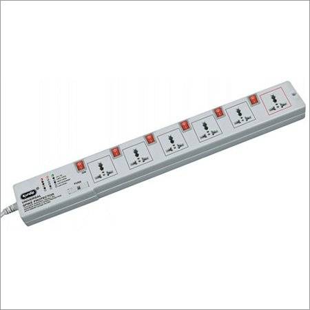

I live in India. I googled UK spike guard images
I'll try to post the photo of my spike guard and the error tomorrow. Maybe the problem is with the spike guard. I'll bring it to office and check it. I got plenty spike guards at office. So that should help me figure out if the spike guard is defective or not.

I too have a power strip but it's not so smart as your "spike guard", has only one light.
It alerted me to a problem which the GE tester showed to be reversed L-N.
Yours appears to have multiple lights so, perhaps it does everything my little GE tester does.
I keep one of those testers in my toolbox. Friends often ask for help with electrical problems and it's come in handy quite often.
Just a couple bucks more gets one with a pushbutton that tests GFCI breakers by allowing a trickle of ground current.
