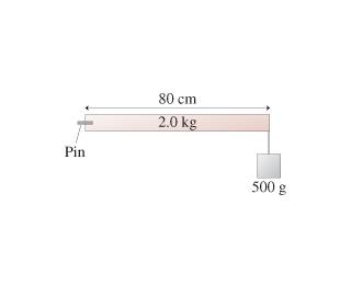

Line of action from pivot to force should be zero?
The discussion centers on the confusion regarding torque calculation when a force's line of action passes through a pivot point. It is clarified that while a force acting directly through the pivot does produce zero torque, the pin can still generate torque due to other forces acting on the system. The original poster mistakenly attempted to use the center of mass as the pivot point, which led to incorrect torque calculations. The key takeaway is that the torque produced by a force depends on its distance from the pivot point, not just its line of action. Understanding the correct pivot point is crucial for accurate torque analysis.
johnnyboy53
I am seeing the steps on others who have worked this out and they are taking the pin as the pivot position. I thought a force's line of action that passes the pivot position produces zero torque? So i tried to make the center of mass the pivot position and each calculate each torque with respect to the center of mass, which is the wrong approach. So why can we say that the pin produces a torque when the force of the pin's line of action crosses the pivot position? Shouldn't that produce a torque of zero?
The diagram is not enough to describe the problem. Please provide full context.
