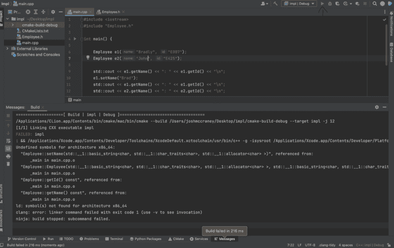

I have the following two files stored in the folder "impl" on my Desktop, the CLion IDE and am running on a mac: main.cpp:
C++:
#include <iostream>
#include "Employee.h"
int main() {
Employee e1("Bradly", "E007");
    Employee e2("John", "E425");
    std::cout << e1.getName() << ": " << e1.getId() << "\n";
    e1.setName("Brad");
    std::cout << e2.getName() << ": " << e2.getId() << "\n";
    return 0;
and then a header file Employee.h
C++:
#pragma once
#include <string>
class Employee
public:
Employee(std::string name, std::string id);
    std::string getName() const;
    std::string getId() const;
    void setName(std::string name);
private:
std::string m_name;
    std::string m_id;
When clicking the green triangle "run" (see the arrow in the image) I get the error the image shows (see the file structure upper left if this helps):
Any idea what I'm doing wrong? Thanks so much!

Aren't you supposed to provide implementations for the getter and setter functions in your employee class definition?
Something along the lines in this example:
https://cplusplus.com/forum/beginner/254961/
where you can see implementation code for the getters and setters. The getters return the private attribute like m_name or m_id and the setter updates the m_name attribute.
Your errors as best as I can read the tiny print in your screencap indicate that the getter and setter methods are undefined symbols.
This code is a very simple example. It should be obvious that the header file contains only declarations of these two class methods, with no definitions for them. Of course, the linker will complain.

Wow, I definitely forgot about writing a .cpp file. Feel like a moron looking back at this now, but thanks for the help! And in the future I'll post the error in text rather than a screenshot. Thanks so much to you all!
