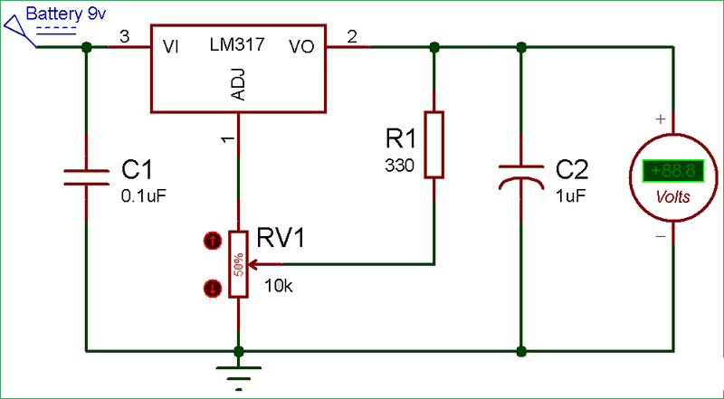

John1397
189
I purchased a buck regulator I apply 12 volts dc to in and get 11.5 volts out turn screw on pot makes no changes measured pot goes from 4k to zero ohms if one unhooks connection to terminal 1 adjustment to LM317 will this give you the minimum voltage of about 1.5-1.6 volts? I want 12 volts in and 1.5 to 1.6 volts out.

OK looking at your circuit which I couldn't see earlier, it wasn't showing up for me
you have not wired the adj and fixed resistors correctly, so this part of my earlier post is still valid ....
davenn said:
You should always refer to device datasheets to learn how to use them properly :smile:
if this is the circuit of yours and is the way you wired it, then it's incorrect and it will not work
read the datasheet for the correct wiring ...
see what you did incorrectly ?
R1 should go straight to the Adj pin of the Reg, NOT to the wiper of R2Dave

R1 = 110 Ohms (connect between pins 1 & 2, Adjust & Output)
R2 = 27 Ohms (connect between pin 1 and GND)
This should yield about 1.56V output. Depending component tolerances, this may differ as much as 0.3V either up or down.
If you want the output lower, make R2 a lower value.
An on-line calculator can be found at: http://www.muzique.com/schem/lm317.htm
Notes:
  1. The LM317 needs at least 10mA of load current, that is why the resistor values were chosen lower than the datasheet 'typical' values.
  2. For minimum output voltage of 1.25V, R2 may be zero Ohms, that is pin1 Adjust connected to GND, which means the lower end of R1 is also connected to GND..
Hope this helps.
Cheers,
Tom
p.s. John, if you are comfortable calculating a resistor voltage divider, here is another way of looking at it.
The LM317 tries to keep the Output pin 1.25V higher than the Adjust pin. This means the divider output, when fed with the desired output voltage, must be 1.25V lower than what you want the output to be.
In your case you want about 1.55V output so the divider must supply 1.55-1.25= 0.3V to the Adjust pin. That defines the ratio of the resistor values. The total resistance of the two resistors in series must also be low enough for the minimum LM317 load current to flow. The minimum load current is 10milliamperes, the output voltage is 1.55V, therefore the maximum load resistance is 155 Ohms.
The resistors were chosen as the nearest standard values with the correct ratio and allowed at least the minimum current. The actual current thru the chosen resistors is 1.55/137 = 11.3mA.

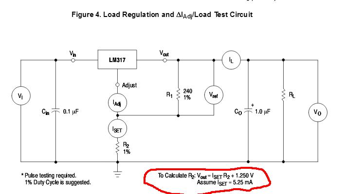

John1397 said:
Is this "Assume I set = 5.25 mA " based off how much load you are applying or is this an LM317 internal operation number or what would cause this number to change?
Your questions suggest that you are not familiar with circuits and Ohm's law. Is that the case ? Please advise as it helps us figure out what help you need.
Here's a picture to help out with what @CWatters just told you.
See datasheet line "Minimum Load Current to Maintain Regulation"
