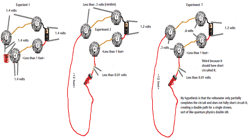

ok so I was creating a connection today and used a 5 v led on a 1.5 v battery. Battery was in a case from radioshack and had insulated leads, full of twisted micro wire. Since there was no way to crimp it or strip the wire without me ruining the twists, I just bundled it to some non twisted wire and crimped it with aluminum foil. So I made an aluminum foil circuit with copper wire. The voltometer measured a steady 1.4 volts. There were a total of 4 aluminum foil crimp terminals, and the voltomer reads were good on all of them, 1.4 volts. (The voltometer completed the open circuit.) So I connected the 5 v led to the last 2 terminals, and the led didn't light. Yet, the LED completed the circuit, I touched the voltometer leads to the LED leads not the aluminum foil terminals. So the led was either defective or did not light at all with 1.5 volts. It was one of those flashing led's. I turned the lights off to verify...no light, a lightbulb did not light either. So I am going to have to buy a led rated at 1.5 volts. But other than that, all and all was good with the circuit, until...
i then attached a 12 foot long insulated thin copper wire to it. Can't remember the gauge, it was the thinnest I could find though. All of a sudden things went haywire. In order to test it, I stripped some of the insulation, past the 3rd and 4th aluminum foil terminals. I attached the voltometer leads to the 12 foot long wire. Readings were erratic, and the battery started to heat up. Readings fluxed from 0.1 to 0.3 volts. Behavoir exhibited a strange pattern. The further I got from the battery, the more the voltage dropped. The closer I got, the higher the voltage. This was bewildering, because it occurred even imbetween the original aluminum foil crimp terminals! It should have short circuited and became like the original model, yet instead of behaving like the original model, where all aluminum foil terminals measured 1.4 volts, this time the 4th and 3rd has less volts because they were further away, and the 2nd and 1st had more volts than the 4th a 3rd terminals, but still not as much volts as directly touching the battery, the voltage behaved as a proximity value. For instance, even at a close range, moving the voltometer leads a few inches closer to the origin would increase the voltage by a high value, the closer it got to the battery. This was bewildering, because it did not behave like a short circuit, which should have reverted its behavoir to the original model. I had to end the experiment short because after adding the 12 foot wire, the battery was heating up and losing voltage at a rapid rate. Does anyone have a explanation for this phenomenon?
Also, close to the terminal the 12 foot wire was wrapped around a screw about 30 times. No discernible magnetic force was generated, as expected. I will post a picture diagram of the experiment, if need be.
Your connections are bad. Strip them (or sand off varnish if magnet wire) before twisting. Forget the foil. Make good connections and retest.
Measure the drop across your connections if you don't believe me. For example, why does the voltage drop to 0.6, the 0.3 after the connections in #3? The connections should not drop more than the wires.
Something is wrong in experiment 1. You can't measure 1.4v between nodes 1 and 3 unless the connection between them is open circuit.
A voltmeter should have high impedance so using one to "complete a circuit" doesn't make sense.

Those were the experiment results. Maybe the connections were bad and it was an open circuit.
I don't have a solder so I am going to crimp it today and retest the results using crimp connections instead of foil.
You can't expect a 5V LED to light up with 1.5V, so you need either a bigger battery (9V, e.g.) or lower voltage LED. You should include a current-limiting resistor as well, unless your light is an assembly that includes one. Use Ohm's law to figure out the appropriate resistance. For instance: if you had a 1.5V LED and a 9V battery, and want to limit current to 20 mA (should be a good starting point), R=V/I or R=(9-1.5)/0.02=375 ohms. A 390 ohm resistor is close enough.

I repeat --- the connections are bad --- the connections are bad ---- the connections are bad. See picture three measurement from 1 to 2.
It's also possible (in addition) that the LED burnt out when you first connected it, or that it is connected backwards (in addition to the voltage being too low).
So many things are wrong. Fix the connections, increase the voltage for the LED, and provide a current limiting resistor.
And, as explained above, a voltmeter is like a very high impedance resistor, >10Mohms probably, so it's effect on the circuit is minimal. If you set it to measure current, then it is a very low (but not zero) impedance.

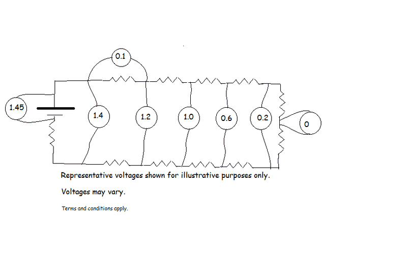

It should have short circuited and became like the original model, ... it did not behave like a short circuit,
Resistors are conductors and conductors are resistors. A "short" is a relative concept - a resistance much lower than the source or conductance much higher than the load.
I can't understand how a "short" would make it like the original model, where you had an "open" circuit (a LED below its threshold voltage.)
... the 4th and 3rd has less volts because they were further away, and the 2nd and 1st had more volts than the 4th a 3rd terminals, but still not as much volts as directly touching the battery, the voltage behaved as a proximity value.
So you have a battery in series with a chain of resistances. The voltage drops over each resistance. You measure the biggest voltage at the battery terminals and lower voltages further away as the voltage drops through each bit of resistance.
The battery has internal resistance. When it supplies current to an external resistance, both the external resistance and the internal resistance heat up according to P=I2R.
12' of wire may loose heat faster than a small battery, so you may notice only the heat in the battery.
The internal resistance causes a voltage drop proportional to the current V=IR, so the battery voltage is always lower when supplying current.
