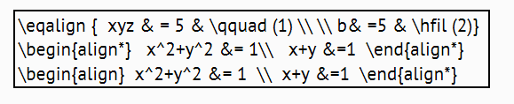

Thanks, Fredrik !
So we have the \eqalign { ... } and we have the \begin{align*} or {align} environment
Code:
 $$ \eqalign { xyz & = 5 & \qquad (1) \\ \\ b& =5 & \hfil (2)} $$
$$ \begin{align*}   x^2+y^2 &= 1  \\  x+y &=1  \end{align*} $$
$$ \begin{align}    x^2+y^2 &= 1  \\  x+y &=1  \end{align} $$
$$ $$ \begin{align*} x^2+y^2 &= 1\\ x+y &=1 \end{align*}
$$ $$ \begin{align} x^2+y^2 &= 1 \\ x+y &=1 \end{align}
And if you make a mistake you get
It seems to work, provided you keep them enclosed in separate ##\$\$## ... ##\$\$ ## -- and wait patiently for the post processor to show the equations after a while.
And previewing gives you ever-increasing equation numbers, but the final numbers start at a lower value.
How about referencing these numbers in \begin{align} ?
I still feel like I'm venturing ouside the comfort zone with this...
