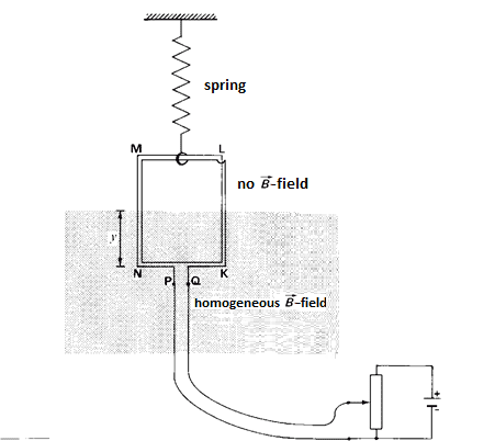

> Figure 1:
> A spool is hung on a spring. A part of the coil hangs in front of a
> homogeneous magnetic field. The coil is incorporated in an electrical
> circuit. See Figure 1.
> the coil KLMN has a rectangle shape, has a height of 10.0 cm, a width
> of 8.0 cm, and has 200 windings of which two are shown in Figure 1.
> The electrical circuit comprises a power supply, a sliding resistance
> and the coil, connected in the manner shown in Figure 1
> The distance between the bottom of the coil and the borders of the
> magnetic field is referred to as y. See Figure 1. If the power source
> is not yet connected, y is equal to 5.0 cm. The voltage source will
> now be connected, so that the spring will be stretched further and a
> Lorentz force will be exerted. The current in the coil can be changed
> by chaging the resistance. If there is a larger current, the spring
> will stretch more.
A.When calculating the LorentzForce : Fl=N*B*I*l Is the length (l) 8cm or 10cm? And why?
B. If the value of the current intensity is at a certain value, the coil length does not appear to increase any further with an increase in the current intensity.
Why is this the case when y=10 cm and how to apply the righthandrule in here?
Fl=N*B*I*l
righthandrule
A. I don't know why it should be 8cm...
I think 10cm, is because the height of the coil. But I don't see why it should be ten, because when there is no current y is already 5. And I don't see how you can use the righthandrule to show that the coil is going upward after y=10cm.
The current is up in the KL section of the coil, down in the MN section and from left to right in the NK section.
What is the direction of the force on the horizontal and vertical sections of the coil?
The coil does not go upward at y = 10 cm. It stays at 10 cm.
BTW it's not stated but from the description of the situation it's obvious that the B field points out of the page.

In your case you can get the total Lorentz force on the spool by
[tex]\vec{F}_{\text{mag}}=\frac{N I}{c} \int_{\text{spool}} \mathrm{d} \vec{r} \times \vec{B},[/tex]
because for simplicity you can model the spool as an infinitely thin wire wound [itex]N[/itex] times over the rectangular frame.
I guess, what you are supposed to calculate is the situation where the spool is at rest (the fully dynamical problem is not so simple, particularly when you want to include the induced current and the backreaction to the motion of hte spool). For the static case you have to evaluate the force balance
[tex]\vec{F}_{\text{grav.}} +\vec{F}_{\text{spring}} + \vec{F}_{\text{mag}}=0[/tex]
from which you can determine the value [itex]y[/itex] for a given current.
Note that there is a change as soon as the spool is fully within the region of the magnetic field!
