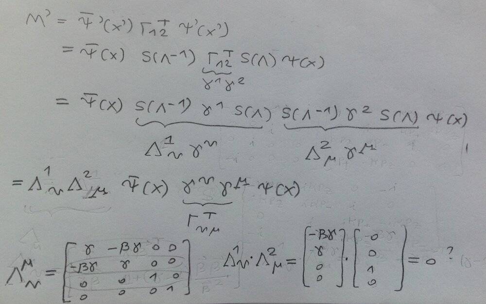

Dear reader,
there is a physics problem where I couldn't understand what the solutions.
It is about the lorentz transformation of a bilinear spinor matrix element thing.
So the blue colored equation signs are the parts which I couldn't figure out how.
There must be some steps in between which were skipped on the solution.
For example, we know that the original matrixelement contains Γ12T. Why does it turn back to ΓμνT? Where does the Γ02T element come from?
And lastly, why did we have to transpose the Γ's in the end, so that the indices get to the top?
Thank you very much for your time :)

Handwritten derivation of a Lorentz transformation of the bilinear spinor matrix element M(x) = psi-bar gamma^3 gamma^5 psi, with the transformation matrix given and the transformed expression for M' written out in steps.

First question first. Suppose
$$A_{\mu \nu} =\bar{\psi} \Gamma^{T}_{\mu \nu} \psi.$$
In the primed frame, what is ##A'_{\alpha \beta}##?

Sorry, my hint wasn't very good. Try this. Write
$$M' =\bar{\psi'} \left(x'\right) \Gamma^{T}_{12} \psi' \left(x'\right).$$
Now write each ##\psi' \left(x'\right)## in terms of ##\psi \left(x\right)##.

Maybe like this?
M' = \bar{\psi} \: (x) S(\Lambda^{-1}) \Gamma^{T}_{12} S(\Lambda) \psi \: (x)

Now use ##I = S\left(\Lambda\right) S\left(\Lambda^{-1}\right)## between the ##\gamma## s.
So I just figured it out. :)
Although the indices are upside down, but I have a feeling they are the same as in the solution.
Now I'm stuck at the second part:
what am I doing wrong here? Am I using a wrong lorentz matrix?
Handwritten derivation of a Lorentz-transformed spinor bilinear: M' = ψ̄'(x')Γ ψ'(x') rewritten with S(Λ) factors, then a 4x4 matrix Λ with entries γ, -βγ, and a dot product of two column vectors that is set equal to 0 with a question mark.

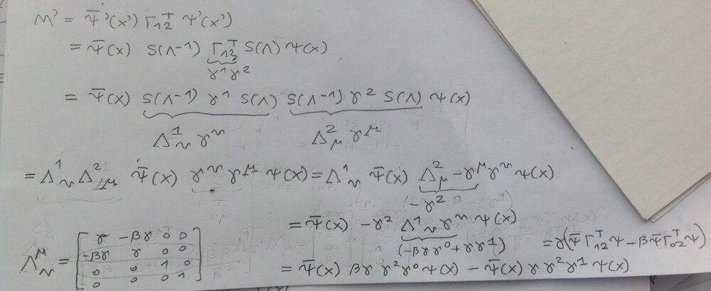

I understand it! I can't believe I did it! I feel intelligent :cool:
Handwritten derivation on lined paper of a Lorentz-transformed bilinear spinor matrix element, with a 4x4 block matrix Lambda^mu_nu of gamma and beta entries shown at bottom left.
Thank you so much for helping me!
