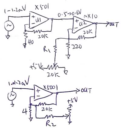

Howdy, I'm using the opa2350 op amp to amplify a <1mV signal by 2000. The problem is I want to have a greater gain (either second stage or larger feedback resistor) however the DC level is reaching too high so that it reaches over 2 V, and I need it under 2 V in order for a digital read into an Arduino. Does anyone have suggestions on how I can reduce the DC level? I would DC couple with a capacitor, however that would cut off half of my signal since it is a single supply op-amp, and I would rather not do that. Any help would be greatly appreciated.

Well here's the basic idea. Take in an optical AC signal into a photodiode, use a TIA to get a corresponding voltage. Projected output range of the TIA is from 0-200uV at 1kHz.
I want to amplify this AC signal to have (at minimum) a 2 Volt swing between 1.5 V and 2.5 V. These high and lows aren't required, however I do need the min to be below 2 V and the max to be above 3V.
I want a gain greater than 2000, it will probably end up being around 10000, however I can't implement this gain yet because I am having an offset DC voltage that is amplified from 1mV to 2V.
Is there a way to lower the DC level without using the DC coupled strategy that would end up cutting my signal in half since i am using a single-railed op amp??

The DC output level of the TIA is at 1mV. The AC output is from that 0uV to 200uV.
So output of TIA = 1mV(1mV+0uV)(lower limit) to 1.2mV(1mV+200uV)(higher limit).
I need the output of the amplifier lower limit to be below 2V and the higher limit above 3V.

You have to tell me exactly the output, not just below 2V and above 3V, I use 2V and 3V here:
1) For signal, you want to map (0 to 0.2mV) to (0 to 1V)[itex]\Rightarrow\;[/itex] Gain=5000
2) DC offset is from 1mV to 2V so offset gain is 2000.
You are going to need two op-amp to do this.

I apologize for my vague answers. Ideally, I need an output of 0(lower limit) to 3.5 V (higher limit).
(The reason for this is I am inputing this into an arduino digital input which reads a low as below 2V and a high as above 3V)

As I mentioned before, I am using the OPA2350.
Some stats for this op amp are.
GBW = 28 MHz
input offset voltage = 150uV
input bias current = +0.5 pA
Here is the circuit, I have not calculate the resistor R1 or R2.
151207[/ATTACH]"]
I drew two circuit, first is with two op-amp, the second is with single op-amp. You can try either one. I set this to signal gain to 5000 to give range of 1V. I create the offset by R1 and R2 using a potentiometer.
As you can see, if you try straight gain of 5000, the output would want to go from 5V to 6V. When I use the R1 or R2 and pull to some positive voltage, that will drive the output of the opamp down. You can calculate the resistors to do the job. It is not that critical as you are using a potentiometer to adjust to the range you want. R1 and R2 has to be a few KΩ to minimize the effect on the gain as R1 or R2 is going to be in parallel with the 40Ω or the 4Ω resistor and change the gain a little. You adjust the potentiometer to get the offset of the output to the window you want.
I have not double check my work, I thought I post what I think and let to pick up and run a little first.
Also, I am using the +5V supply for voltage reference, any drift will cause error. But adding a voltage reference will be more complicated.

A couple questions:
1) What's the difference between the two? Is there a reason one would chose the circuitry with 2 opamps or is it just a matter of preference?
2) The pot in the bottom diagram. What's the value of the pot? I see in the top diagram has a pot of value 20k. Is the pot on the diagram 20k as well?
Thanks so much again.
A 20K will be good.
I drew two as one stage implies the gain is 5000, kind of make me nervous. But you can try it as your amp is 28MHz.
I just put in some value to get the gain, you can massage the value according to the availability of the resistor. BTW, I don't like the 4Ω for one thing as you need so much gain AND I really don't like to use a large feedback resistor for a high speed amp either.
