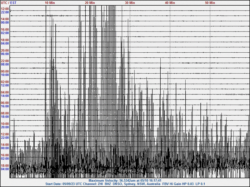

A decent event that maxed out my seismo for some minutes
https://www.sydneystormcity.com/seismograms.htm
As it will disappear off my seismo in around 20 hours ( from time of writing this) a screen grab below
saved for posterity :smile:
cheers
Dave

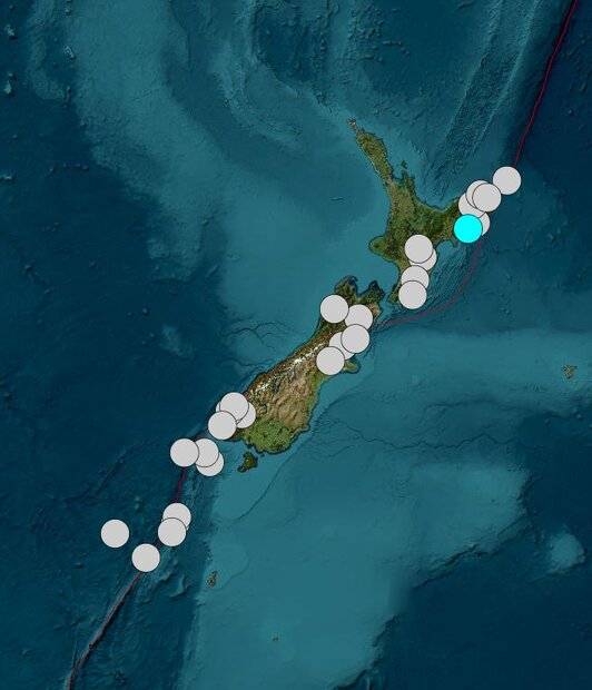

USGS map for NZ region events, M7.0 and greater, since 1929 ( they dont list any earlier ones)
