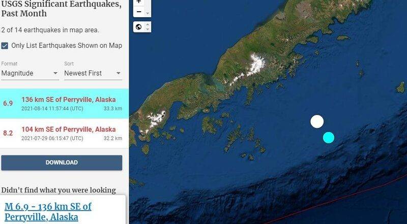

Possibly related M 6.9 - 136 km SE of Perryville, Alaska
  • 2021-08-14 11:57:44 (UTC)
  • 55.085°N 157.540°W
  • 33.3 km depth
https://earthquake.usgs.gov/earthquakes/eventpage/ak021adyci6n/executive
Comparing the location of the 8.2 M earthquake: 55.325°N, 157.841°W, 32.2 km depth
with the location of the 6.9 earthquake: 55.085°N, 157.540°W, 33.3 km depth
The lateral separation assuming an ellipsoidal Earth 20.431 statute mi, 17.754 naut. mi, 32.880 km
Using https://stevemorse.org/nearest/distance.php
definitely related, as in, an aftershock... it's just a bit up dip from the 8.2 ( ~ 50km)
Dave
