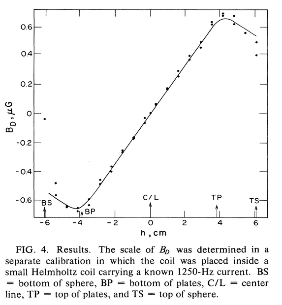

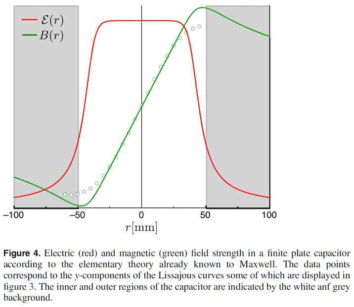

@Baluncore, that's simply wrong.
At least two experiments have successfully measured the magnetic field existing between the plates of a sinusoidally-charging capacitor and verified the formula in post #8; i.e., ##\vec{B}(r)\propto r\,\hat{\theta}##. In 1985 Bartlett and Corle immersed a capacitor in liquid helium within a superconducting sphere and used a SQUID probe to quantify the field. More recently, Scheler and Paulus in 2015 employed a different apparatus to make the measurement:
For a good overview of this subject see: John A. Milsom, Untold secrets of the slowly charging capacitor.

@Baluncore, the two independent experiments I cited both agree and clearly demonstrate that:
a) there is a nonzero magnetic field in the dielectric (liquid helium for the first and air for the second) between the capacitor plates and
b) said magnetic field agrees well with the theoretical prediction:
Please clarify your position: do you reject these peer-reviewed and published experiments that contradict your statements above? Can you offer an alternative explanation for the graphs?
