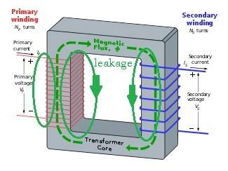

Hi, initially I have read that magnetic flux is conserved in iron core, also I know divergence of B is zero but this conservation implies that there is no flux at the interface of air and iron core surface. We still magnetic field even at the interface so there must be flux. Why do we exclude this part?
If the plus and minus poles of a magnet are brought together with a small gap, the ## B ## is continuous through the air across the gap. ## \\ ## Meanwhile, for cases like a square transformer geometry, the approximation can be made that the flux stays entirely within the square iron transformer. ## \\ ## You might also find this recent discussion of interest: https://www.physicsforums.com/threa...a-magnetic-circuit.955585/page-2#post-6059155

Thanks @Charles Link, but I would like to see the proof of approximation that the magnetic flux from surface of iron core to air is negligible. I can not imagine that it is negligible because the magnetic field is not very small. Could you help me about that?
There will be some leakage flux. If you look at post 16 of the "link" that I gave above, and a publushed paper that is shown there that describes this in detail, there is actually a possibility that this leakage flux is necessary to explain how the Poynting vector operates in regard to power transfer in the transformer. ## \\ ## It can't be proven that it is zero, because it isn't.

What is the direction of this magnetic field that you say is not very small? If it's parallel to the axis of the core then there is no flux through the surface you mentioned.
I try to say there are of course some places normal magnetic field at the interface between air and iron core is not small...

Referring back to that long tome i wrote in the old thread @Charles Link mentioned, https://www.physicsforums.com/threa...we-apply-the-biot-savart.927681/#post-5979758
Leakage inductance is present because of flux that doesn't couple both windings..
From the Wiki transformer page:
i just drew in a few loops of leakage flux..
Thought steps required to accept the premise that MMF and hence leakage flux is small:
When there's no secondary current
the only MMF present is from primary magnetizing current
and that MMF will be small
because it's just Flux/Reluctance( of core)
and that's why in a power transformer magnetizing current is generally considered negligible . It is made by design small compared to rated load current in order to make the transformer efficient.
So leakage flux at no load will be roughly 1/(relative permeability of core) X (flux in the core)
and with relative permeability probably at least several hundred if not several thousand,
leakage flux to slide rule accuracy will be zero .
With more digits it'll round off to maybe as much as 1% of core flux which is still near zero.
So how does MMF ever get large ?
Initial Refinement to that thought process
Okay let us add secondary current.
As explained in the tome referenced above,
primary MMF increases because of secondary amp-turns.
Okay,
Leakage flux will increase in same proportion ,
but core flux remains the same as before, (voltage is the same)
so leakage flux becomes a larger fraction of core flux than it was at no load.
and as you stated leakage out into the air is not any longer so small.
Designers can control by how much leakage flux increases with load to give the transformer its desired impedance .
