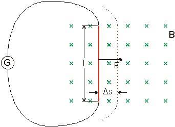

Well, The proof upthere isn't mine. It is from my book which sounded weird. Let me try to demonstrate what it proved
Assume you have this setup
What the book said is if you move the rod to the left with velocity v to the left a magnetic force will act upward (across the wire) with a magnitude of qvB.
So It said, the work done is qvBL, However that doesn't make sense because magnetic forces don't do work because of the whole cos 90 = 0
But if you use it to find the Emf which is ## Emf = \frac{qvBL}{q} = vBL ## which gives the same result of faraday's law
So it gave the right result, that leaves us with 2 choices either it is a coincidence or there must be a force acting upward that can do work. so I assumed it can be electrostatic force.Dale, Yes I am familiar with different frame of references. Are you going to talk about special relativity and how distances are going to be shorten from a rest frame of a moving charge which means by coulomb's law it will have a force greater in magnitude?
No, my line of reasoning is non relativistic. If you really use a relativistic framework then the whole question disappears since there is no separate magnetic field. This is basically just an analysis of the E.J term in Poynting's theorem considered in a frame where a conductor is moving and a frame where it is at rest.
The work term ##E \cdot J## includes all the work done on matter, including but not limited to the Ohmic losses. So I wanted to see if any further analysis of that term could be done to pull out the Ohmic losses.
If a piece of material is moving at velocity ##v<<c## then we can make the following transformations:
##E' = E + v \times B##
##J' = J - \rho v##
where the primes indicate values in the reference frame where the material is at rest.
Substituting those in we have:
##E \cdot J = (E' - v \times B) \cdot (J' + \rho v)##
##=E' \cdot J' + E' \cdot \rho v - (v \times B) \cdot J' - (v \times B) \cdot \rho v##
##=E' \cdot J' + \rho v \cdot (E+ v \times B) - (J-\rho v) \cdot (v \times B)##
##=E' \cdot J' + \rho v \cdot E - J \cdot (v \times B)##
So finally we end with
##E \cdot J=E' \cdot J' + v \cdot (\rho E + J \times B)##
Since ##E'## and ##J'## are in the reference frame of the material, I would interpret the term ##E' \cdot J'## as being Ohmic losses. Then ##E \cdot J## contains not only the Ohmic losses, but also the material velocity times the Lorentz force density, which I would call the Lorentz power density.
I don't have a reference for this, so I don't know if someone else has already done this derivation.

Oh thanks for the answer,I also found a really good way to prove that magnetic forces don't do work but they might transfer energy.
Assume you have that same wire moving to the left with a velocity of V
Lets assume it has positive charges moving
So a magnetic force will act on the charges causing them to actually move upward in some sort of circular motion (Transient state). It is quite complex to explain how it moves them in the transient state but we can show after reach the steady state how this works.
So you will have the positive ions moving left direction and upward due to the current induced. Inside the wire, because the charges moved initially upward and stacked there we have an electric field and this will end after the two forces of the magnetic and electric field are equal.
Now we have two components of velocity you could combine them and show that the overall magnetic field will be perpendicular to the velocity thus no work, But that doesn't explain why the charges move. Okay now keep the two components of velocity, They will generate two components of magnetic field one in the y direction due to the movement to the left and one in the -x direction due to the movement of the current.
in the y direction we have the force of ##q~V_{rod}~B## and on the -x direction we have a force of ## q~V_{drift velocity}~B ##
Now we have to prove that the overall work of the magnetic field is zero
lets look at the -x direction, If the rod moves with a velocity of V then we can say that the work done by the force of the magnetic field is
##- q~V_{drift velocity}~B ~ V_{rod} t## where t is really small
But the in the Y direction we have ## q ~ V_{rod} ~ B ~ V_{drift velocity} * t ## and here we can see that the two work are equal. Which means it only transfers energy and Energy is just conserved.
