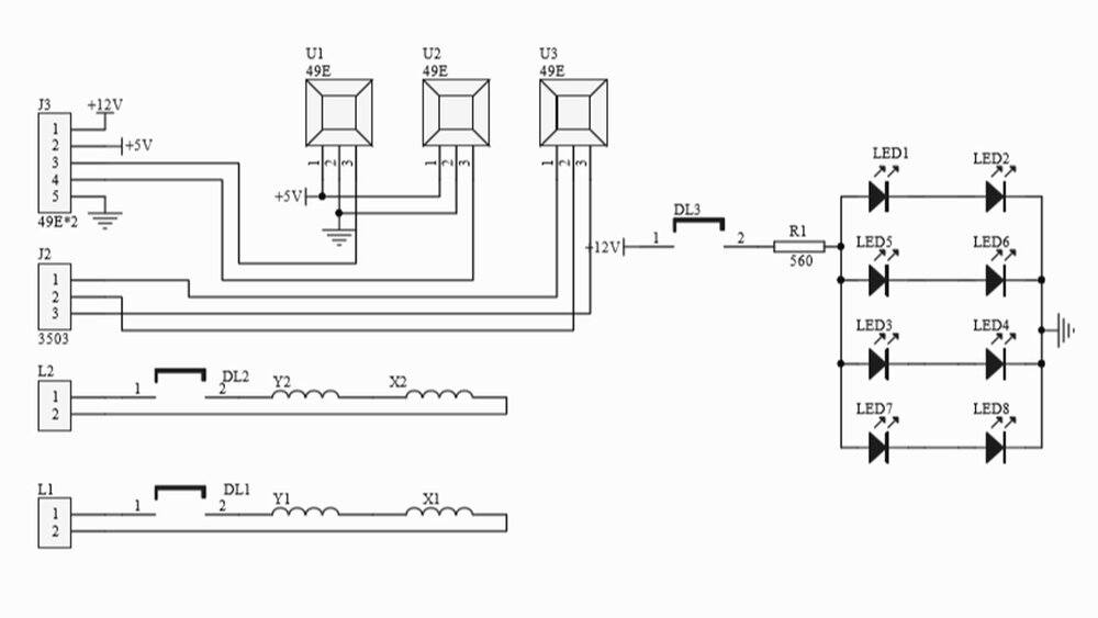

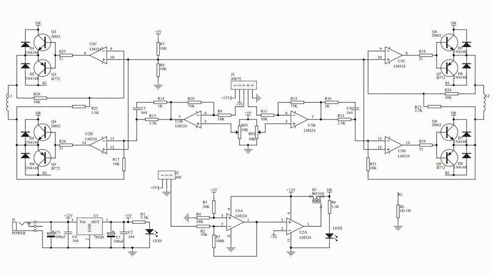

Hi. I'm designing a magnetic levitation board based on schematics attached herewith. However it does not levitate the magnet. Plz note Q1 is P channel MOSFET. Also note that I used coil L1 as X1 & X2 and coil L2 as Y1 & Y2. Where Xs and Ys represents horizontal & vertical directions respectively. I think the original schematic has label errors for Xs and Ys as that confuse with horizontal and vertical directions otherwise I used same circuit. Another thing that I did not used R14, R16, C3, and C4.

Referring to sch_4, any idea what the U1,2,3 sensors are? Do they detect light, or magnetic fields, or ?
Also, what are DL1,2,3?
Edit:
Looking at the circuit again I realized that it is a DC position servo. The U1,2,3 sensors are probably light sensors that detect when and how much the suspended object blocks light from the LEDs.
As such, a ferrous object is needed and following the original L1 and L2 connection instructions would be critical. I suggest you try their original configuration.

Finally it's success with some changes to the original circuit.
Tom.G said:
Please! Please! Details Please!
Well bro I made changes attached in pic herewith. I simply raised Vcc/2 from 2.5 V to 6 V while keeping signals from hall effect sensors at 2.5 V with this circuit. For this to happen please note that resistors R19 & R23 should be of same value and similarly R18 & R24 should be of same value.
  • Schematic of an op-amp difference amplifier using an LM324: HE SENSE X input through R19 to inverting pin 2, +2.5 V REF through R23 to non-inverting pin 3, +6 V REF through R24 to the reference node, feedback resistor R18 from output pin 1 to pin 2.

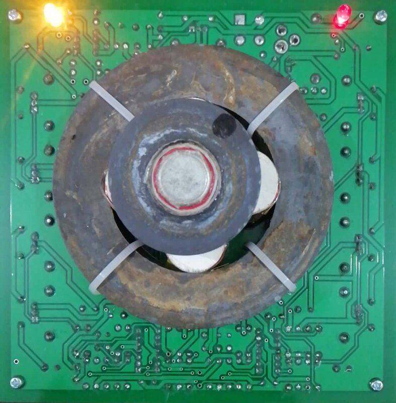

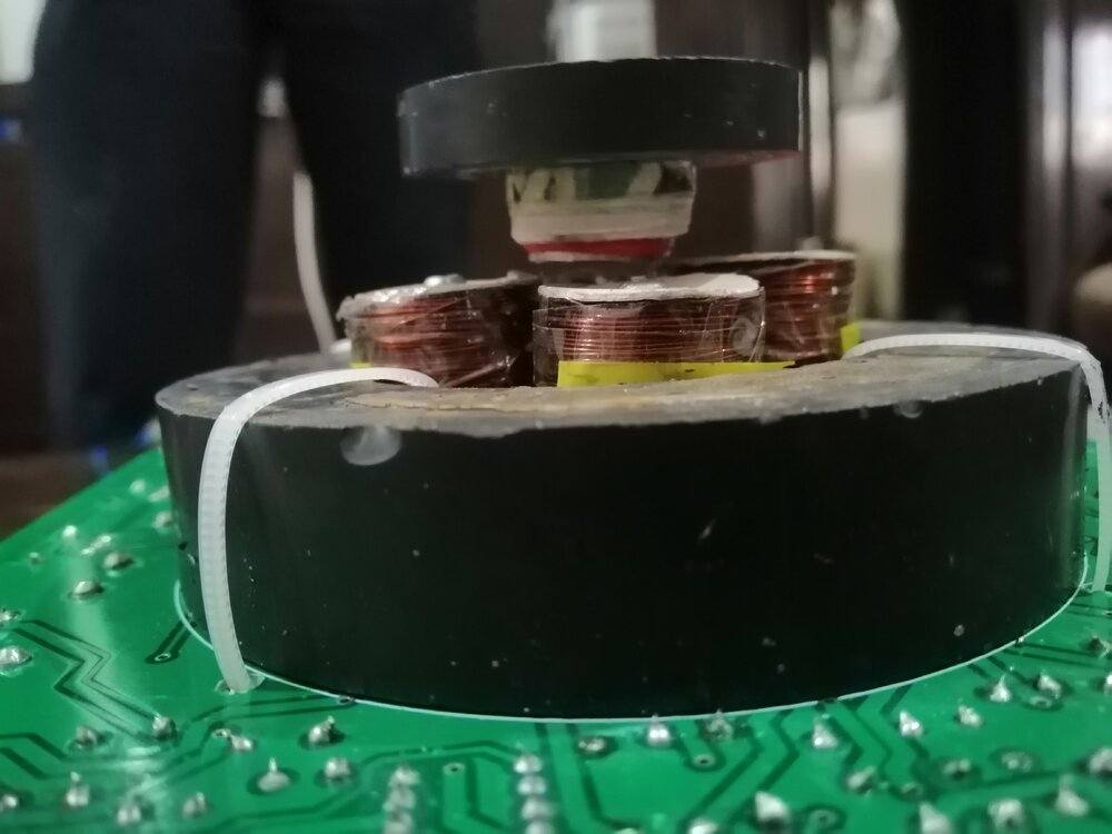

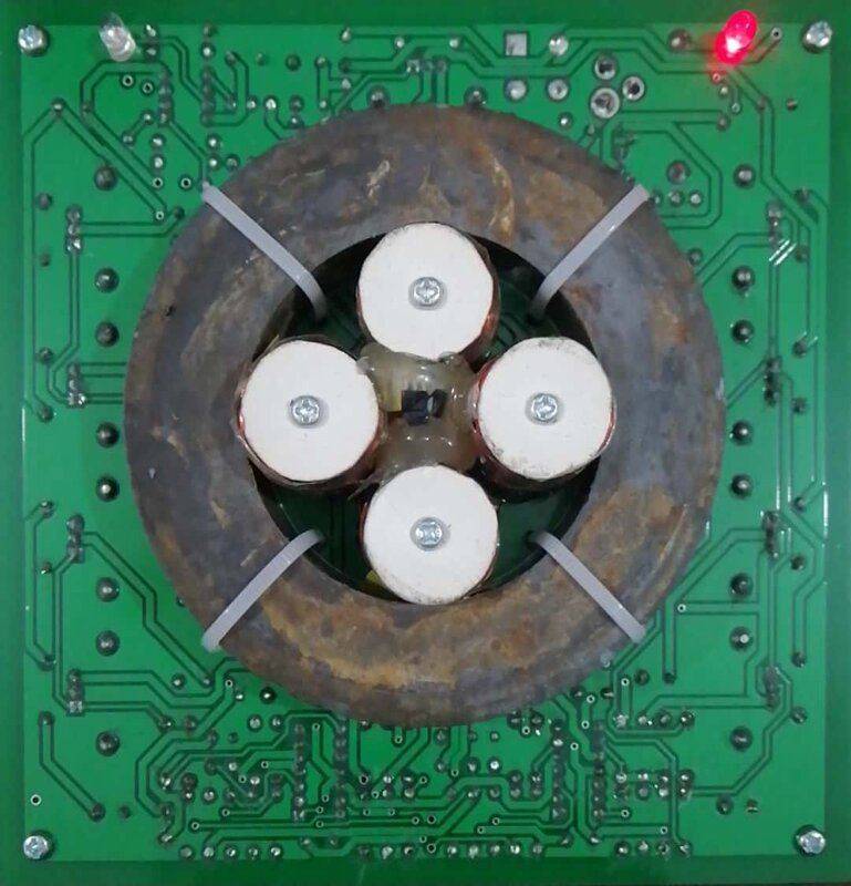

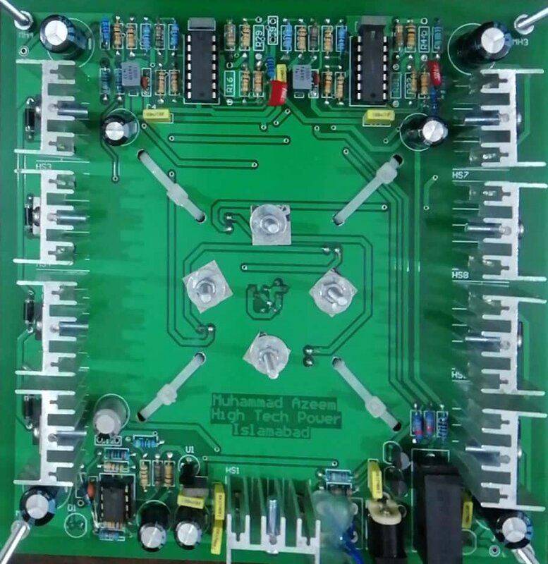

  • Green printed circuit board with a large brown ferrite ring core in the centre, four white cylindrical coils with screws at the top and bottom of the ring, and a red LED at the top right.
  • Photo of a green printed circuit board with a large rusty metal disc and a smaller grey disc held in place by cable ties over a stack of cylindrical magnets, with a yellow LED at top left and a red LED at top right.
  • Top view of a green printed circuit board with heatsinks along the left and right edges, electrolytic capacitors in the corners, two integrated circuit chips at the top, and a central mounting area with four potentiometers. The board is labelled Muhammad Azeem, High Tech Power, Islamabad.
  • Close-up photo of a levitation setup: a black ring-shaped magnet sits on a green circuit board, with several copper-wound coils on top and a black disc magnet floating above them.
