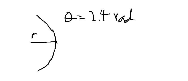

A circular rod has a radius of curvature R = 8.11 cm, and a uniformly distributed positive charge Q = 6.25 pC and subtends an angle theta = 2.40 rad. What is the magnitude of the electric field that Q produces at the center of curvature?
E = kQ/r^2
6.25 pC --> 6.25e-12 C
[itex]dE\quad =\quad \frac { kdq }{ { r }^{ 2 } } \quad \quad dq=\lambda ds\\ E\quad =\quad k\lambda \int { \frac { ds }{ { r }^{ 2 } } cos\theta \quad \quad } ds=rd\theta \\ E\quad =\quad k\lambda \int { \frac { rd\theta }{ { r }^{ 2 } } cos\theta \quad \quad } \\ E\quad =\quad \frac { k\lambda }{ r } \int _{ 0 }^{ 2.4 }{ cos\theta } d\theta \quad \quad \lambda =\frac { q }{ s } =\frac { q }{ r\theta } \\ E\quad =\quad \frac { kq }{ \theta { r }^{ 2 } } sin(2.4)\\ E\quad =\quad 2.4e-4\quad N/C[/itex]
Is this the right answer? What do you guys suggest?
Your limits of integration do not look correct. Be sure you draw a diagram and indicate θ. Also, note that cm is not the SI unit for length.
(theta = 2.4 rad)
I can't visualize any other situation that would change the limits of integration
You didn't indicate how θ is measured in your diagram. Also, you should draw the electric field ##d\vec{E}## at the center of curvature that is produced by a small element of charge and show the angle that the field makes to the central axis (the line that you drew and labeled r). Is the angle that ##d\vec{E}## makes to the central axis the same as the angle θ?

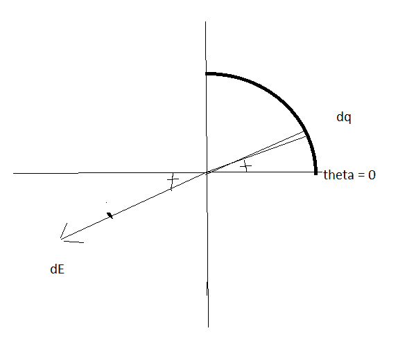

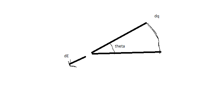

Sorry for the late response, here is what I am getting,
Seems like the angle is theta+pi

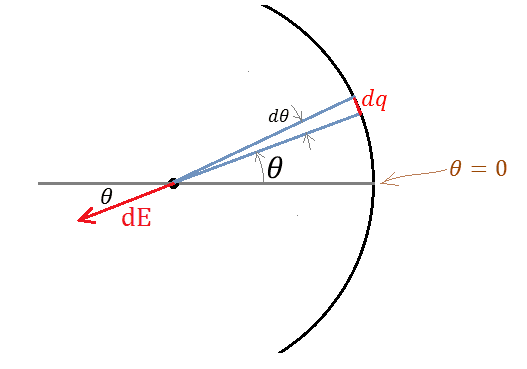

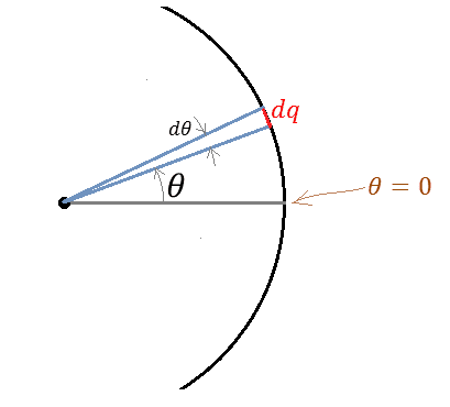

I'm not following. A good place to set θ = 0 is the midpoint of the arc. See below.

Yes, I believe so. And, yes, ##\vec{dE}## makes an angle of ##\theta + \pi## from the θ = 0 direction.

Now, I'm getting the limits of integration from
0+pi
to
2.4+pi
is this right?
(using the same integral equation from the original post)

No. You want to integrate from one end of the charge distribution to the other end. What is the value of θ at each end of the charged rod?
-1.2 to 1.2? from your picture
Yes.
TSny said:
Yes.
I'm getting 6.64N/C, is this the right answer?
Yes, I believe that's correct.

OK, good work. I hope you see why θ = 0 is chosen at the midpoint of the charged arc, rather than at one end. With θ = 0 at the midpoint, then θ also represents the angle that dE makes to the horizontal.

We know E will point along the symmetry axis of the arc (the line that bisects the arc). In my picture, the symmetry axis was the horizontal x-axis that bisects the arc. In your picture, the line that bisects the arc would be at 1.2 radians (68.8o) with respect to your x-axis. (The charged arc should extend beyond the y-axis in your picture.) In your picture, ##-\int_{\theta = 0}^{\theta = 2.4}dEcos \theta## would give just the horizontal component ##E_x##. There would also be a vertical component ##E_y = -\int_{\theta = 0}^{\theta = 2.4}dEsin \theta## that you would need to calculate. Then you could find the magnitude of E from these components.
It is more convenient to define θ in such a way that θ represents the angle that dE makes to the symmetry axis. That way, you only need to do one integral,##\int_{\theta = -1.2}^{\theta = 1.2}dEcos \theta##.
