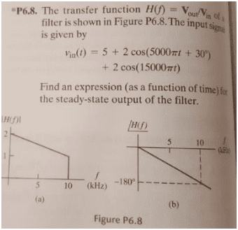

Hi all, In one of my problems there is a question with a plot of the transfer function magnitude versus frequency. In the graph I notice that the magnitude of the transfer function is greater than 1. This is confusing as I thought that filters are not able to increase the magnitude of the output signal with respects to the input as they are only able to attenuated the amplitude or change the phase of the signals. Also to strengthen my case, as the transfer function is H(f) = Vout∠θout / Vin∠θin, shouldn't the magnitude of the transfer function always be less than or equal to 0.

The short answer:
A filter with a feedback loop can accumulate certain frequencies to much higher than the input amplitude of that frequency. Which frequencies accumulate and which attenuate are determined by the phase shift of the feedback.
Transfer functions of filters can certainly be > 1.
Consider a voltage source feeding a series LC. The transfer function of current vs. freq will go to infinity at series resonance.
Active filters can be built to have gain at all frequencies, such as in an audio amp with equalizer.

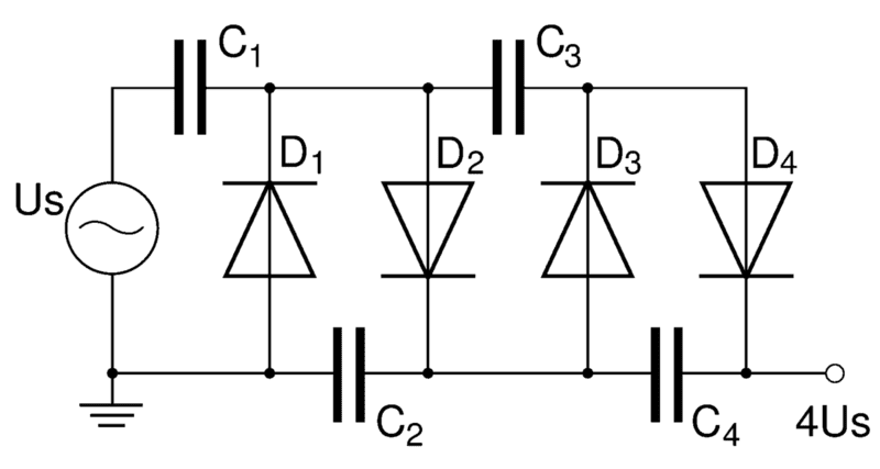

I'm interested and curious, can you supply a concrete, real-world, example without both L & C, and with all passive elements?
No. with only passive components with no energy storage devices (L and C) you are implying that you want no reactance. This means that the values the same at DC and high frequencies. I could point out voltage multipliers, but that has capacitors and diodes.

ahhh ok, in that case see my above post, voltage multiplier made from diodes and caps takes in low amp ac voltage and outputs high voltage dc
Yup, that would do it.

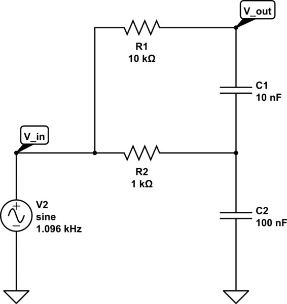

I also found this: https://electronics.stackexchange.c...-network-with-voltage-gain-greater-than-unity

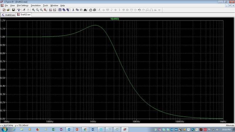

I simulated the circuit that is in the electronics.stackexchange link with LTspice. Sure enough, the gain is > 1 for all frequencies below ~2.2KHz.
The gain peaks to 1.15 at 1.1KHz.
Pretty awesome, I never thought about getting voltage gain out of an RC network.
Not ALL lower frequencies, surely? Are you able to attach a graph?
NascentOxygen said:
Indeed, that is almost certainly the thread I had in mind, from 2008. Have you archived the missing Figure, by any chance?
I did not archive it, but somewhere I have a copy of the Epstein paper.
Graph attached.
Voltage gain is unity right at DC of course, but then moves north of unity until it crosses over at 2.2KHz

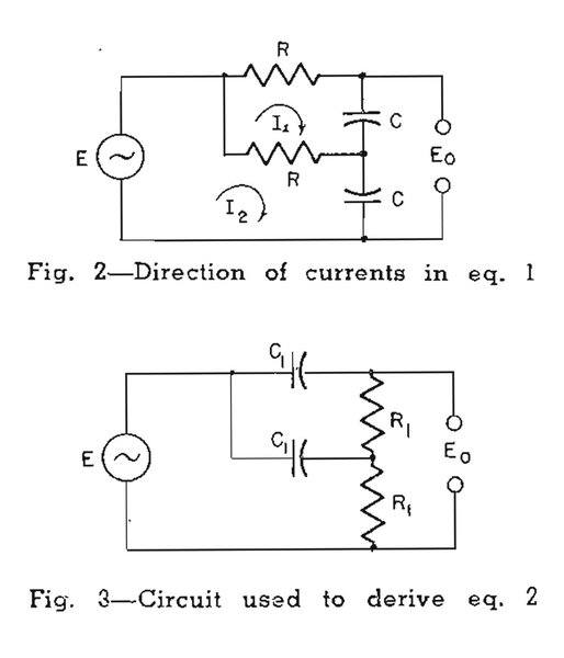

An arrangement resembling a series pair of modified Bridged-Tee networks gives bandpass response with peak gain ×1.12 and zero phase.
An RC Circuit Giving Over-Unity Gain. Conrad L Longmire. TeleTech April 1947 pp 40-41,112. http://www.americanradiohistory.com/Archive-Tele-Tech/Tele-Tech-1947-04.pdf

NascentOxygen said:
Very good. (I was distractedly thinking of the modified Twin Tee with its bandpass response.)
The effect of a load on the voltage enhancement is another consideration in the design of these.
An arrangement resembling a pair of modified Bridged-Tee networks gives bandpass response with gain ×1.12 and zero phase. An RC Circuit Giving Over-Unity Gain. Conrad L Longmire. TeleTech April 1947 pp 40-41,112. http://www.americanradiohistory.com/Archive-Tele-Tech/Tele-Tech-1947-04.pdf
How did you find this? What search terms did you use? I've seen interesting references to that old magazine, Tele-Tech, but I would never have expected that such relatively obscure articles would be indexed.
