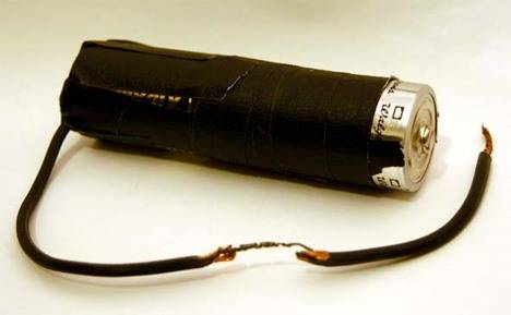

I read an article in prison inventions and was impressed by some of the things the inmates MacGyvered. A very simple invention I saw though was a cigarette lighter made from a battery:
Photo of a homemade battery lighter: a D-cell battery wrapped in black tape, with a thin wire wound across its top terminal and insulated copper leads extending from it.
I have an understanding of basic electronics theory but I have very little practical experience. I can see a piece of thin wire connected to the insulated copper wire, obviously that's the heating element but what material would you say that is? Am I right in assuming that a material for a heating element needs to be far less conductive than conductive metals like copper or aluminum?
Well, less conductive than a normal sized wire, yes, but one COULD achieve that with a REALLY thin strand of copper. Of course it would likely melt immediately. But yes, your basic thought is correct.

Thanks, that clears up my questions. One thing I'm still wondering though is why my fingers heat up if I hold a strip of aluminum foil to both terminals of the battery. The burning sensation on my fingers gets very intense in a matter of seconds. I don't feel any burning if I complete a circuit by holding two pieces of wire together with my fingers. I'm guessing what I'm feeling is electricity itself, not heat generated by the circuit. Is some of the current traveling through my skin (and thus heating the skin up)?
well you are shorting out the battery and the foil is conducing all the current that the battery is able to supply. The foil is getting hot as a result and transferring that heat to your fingers
if you hold a bit of copper wire between the terminals of the battery , the same thing will happen. But you didnt specify that
what sort of circuit were you completing ? if its anything more than one that's close to a short circuit, then no, you won't feel the wire joint getting hot
( will qualify that by saying that it may get warm/hot if really high currents are involved)
That is because there would be a small amount of resistance in a mechanical joint that wouldn't be there in say a soldered joint
