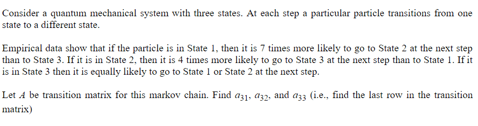

Hi! I have a question regarding making the transition matrix for the corresponding probabilities. The main problem I feel I have here is figuring out how to represent the probabilities in the question in the transition matrix. Like if something is 7 times more likely than something else.. Any help would be appreciated.

If I'm not mistaken $a_{31}$ is the probability that the quantum state shifts from state 1 to state 3? (Wondering)
Then $a_{21}$ is the probability of the transition of state 1 to 2.
So if the latter is 7 times more likely then the first, that implies that $a_{21} = 7 a_{31}$.
The given statements result in:
$$A = \begin{bmatrix}
& a_{12} & a_{13} \\
7a_{31} && a_{13} \\
a_{31} &4a_{12} &
\end{bmatrix}$$
We can combine it with the fact that every row sums to $1$.

Thanks for the reply! Your explanation really helped me to understand how to construct the transition matrix. So when I tried to solve the system for a31, a32 and a33, I got 1/29, 28/29 and 0 respectively. When I put this into my assignment website, I got 1/3... which I think was probably for getting the 0 right. But I don't get what mistake I could have made, because plugging in those values into the rows gives me the expected result of 1...

Rereading the problem statement, I think we can deduce the following:
$$a_{11}=a_{22}=a_{33}=0$$
since it is given that the particle makes a transition to a different state at every step.
(And otherwise we wouldn't be able to solve the system, since we'd have 6 unknowns.)
Additionally, I think it's the column sum that has to add up to 1 instead of the row sum.
That's because if it's given that the particle is in state 1, then afterwards it's either in state 2 ($a_{21}$) or state 3 ($a_{31}$).
So together those should yield a probability of 1.
Finally, are we talking probability amplitudes or actual probabilities? (Wondering)
If they are probability amplitudes, perhaps we have to square them before comparing or adding?

Oh okay, I guess you're right with the columns having to add up to 1. I'll try that and report back what I get.

Hi! Just wanted to let you know that it worked, thanks for your help!
