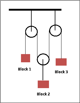

Find the relation between the mass of block 1 and the mass of block 2. Assume that the pullies are massless and frictionless and that the rope is inelastic. All masses are unknown.
Possible answers: mblock2 = mblock1[/B]
mblock2 > mblock1
mblock2 < mblock1
The system below is at rest.
F = mg = T
I'm quite clueless on how to approach this problem, but this is how far I came.
m1*g - T1 = m1*a
m2*g - 0.5*T2 = m2*a
∑F = m1*a + m2*a = m1*g - T1 +m2*g - 0.5*T2
I'm not sure how to go any further.
Thanks in advance for the help!
Focus on Pulley with block 2. Since the pulley is at rest, the sum of forces on that pulley equals zero.
So T1 + T3 - m2*g = 0 ?
m1*g + m3*g = m2*g
m1 + m3 = m2 ?
Am I approaching this problem the right way now?
I found out that I made a mistake in the possible answers. It should be:
mblock2 = 2*mblock1
mblock2 > 2*mblock1
mblock2 < 2*mblock1
The rope has the same tension throughout.
Yes correct. Now notice that the tension should be the same so ##T_1=T_3##.
If T1 = T3 then m1 = m3
This means that m2 = 2*m1 ?
But now I face another problem because according to my teacher, the answer should have been: m2 < 2*m1
Is the rope considered to be massless?
It doesn't state that the rope is massless, so I guess not.
I meant to say that the rope has mass
If the rope is massless then what we did here is correct and your teach is wrong.
However, if the rope is NOT massless, then the tension forces ##T_1+T_3## have to lift the weight of the segment of rope that is attached to pulley 2, so it will be ##T_1+T_3=m_2g+m_rg## where m_r the mass of the rope along the circumference of pulley 2.
The rope is indeed not massless.
Thank you very much for your help.
