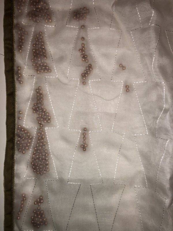

Hello,
I am an artist working on weighted cloth in my practice since 2015. Each piece I make by hand and is extremely time consuming.
I would love if someone would take a look at this and give me any thoughts you might have.
I am working on a project that requires filling thin, fabric channels with beads using tubing. I am looking for a cross between a plastic drinking straw (because it has a very thin outer wall and a large opening) and latex tubing (because it is flexible). The tube has to be wide enough so the bead can pass through, but thin enough on the outside so it can fit into the fabric channel.
Please see the image attached. It is a process photo of one of my pieces in progress.

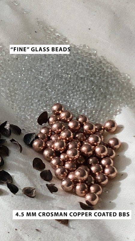

What is the purpose of the beads? Are they hidden and there primarily to contribute weight? I don't see any beads in your pictures. Could you use steel or copper BBs or [lead [toxicity caution]] .177 pellets? What beads do you need the tubes to accommodate? would glass or ceramic beads work?
I actually do use 4.5 mm copper coated zinc bbs, as well as fine glass beads (not together). The purpose is primarily for weight.

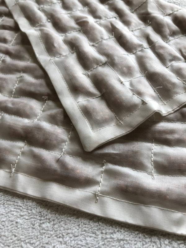

Different pieces have different quilting/sewing patterns to encapsulate the beads, preventing them from gathering. Below is one piece with a staggered brick pattern- it is silk organza (double-layered) with copper bbs inside.
245017
I am also developing one with a triangle pattern that allows for the filling of all the beads at once, instead of having to fill one compartment at a time. The piece below is only partially filled.
245018
For the fabric to be flexible enough to wear, I suspect you won't be able to keep the chambers tight enough that the beads won't bunch up, but I may be wrong.
The beads are allowed to move freely within their chambers.

The issue here is that whatever weight material I am using (whether it's copper-coated bbs, glass beads, etc) tends to get stuck on the fibers of the cloth, inside of the channel. The reason for the extra tubing is for ease of insertion.
p.s. that assumes of course that the sewing is uniform :nb) ... hmm maybe use gravel
Some of them are uniform, some of them aren't. My simplest designs involve uniform channels that I fill and then sew seams to separate into individual compartments.
Or perhaps blow compressed air in along with the beads. This will both expand the channels and encourage the beads to move along.
OK, now I'm more confused. I thought the beads needed to move freely top to bottom. That's why you rejected the idea of stringing the beads on wire.
Not from top to bottom, but within the individual compartments.
Even with the staggered brick pattern, you still start out with long parallel tubes; then, the staggered pattern is simply created by staggering your cross seams after the beads are installed.
