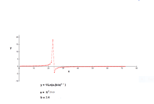

In my original contribution I wondered how k would vary with p I have now found a disconnected curve that answers this, and it results in zero N for all p greater than 2. I'll try to insert this curve.
k = y and p = x
242315
Error in above chart . should be a=e^(2/3.pi^2) b = e^2.pi()
