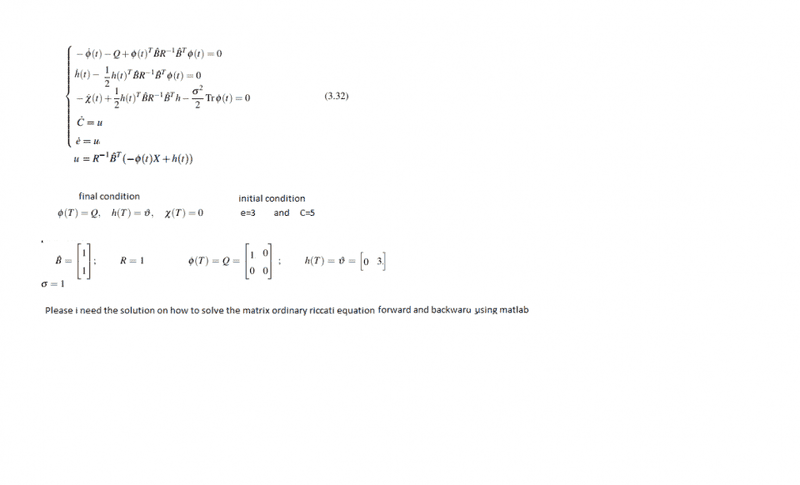

Matrix riccati differential equation using matlab
The discussion revolves around solving the Matrix Riccati differential equation using MATLAB. A user shares their code and requests feedback, particularly regarding convergence issues with the error variable 'e' and the contract 'C'. Other participants point out potential problems in the code, specifically with the reshaping of matrices and the functionality of the defined functions. They emphasize that the reshape function may not be effectively altering the dimensions as intended, which could lead to incorrect results. Overall, the conversation highlights the need for debugging and clarifying the implementation of the MATLAB functions involved.

I can upload the code if you want to see my attempt.

Yes, please do. It's best if you post it inline using code tags. It should look like this:
Code:
<< your MATLAB code>>
Code:
function dPdt = mRiccati(t,P, B, Q, R)
%computes Phi
  P = reshape(P, size(Q)); % Convert from "n^2"-by-1 to "n"-by-"n"
  dPdt = -Q + P' * B * R^-1 * B.' * P; % Determine derivative
  dPdt = dPdt(:); % Convert from "n"-by-"n" to "n^2"-by-1 or converting to column vector
end
function dhdt = mRiccati2(t, P0, B, h, R)
%compute h
  h = reshape(h, size(B)); % Convert from "n^2"-by-1 to "n"-by-"n"
  dhdt = 0.5* P0' * B * R^-1 * B.' * h; % Determine derivative
  dhdt = dhdt(:); % Convert from "n"-by-"n" to "n^2"-by-1
endfunction dXdt = mRiccati3(t,X, h0, P0, B, R, sigma)
% Compute Chi
  X = reshape(X, size(R)); % Convert from "n^2"-by-1 to "n"-by-"n"
  dXdt = (1/2)* h0' * B * R^-1 * B.' * h0- ((sigma^2)/2)*trace(-P0) ; % Determine derivative
  dXdt = dXdt(:); % Convert from "n"-by-"n" to "n^2"-by-1
end
clear all; close all
% sigma=[1 1 1 0.5 0.5 0.5 0.33];
sigma=[1 1 1 1.4142 1.4142 1.4142 1.7321];
q=[1 1 1 1 1 1 1];
C=[5; 5; 5; 10; 10; 10; 15];
e=[4; 3; 2; 2; 2; 2; 3];
    dt=0.1;        %step size
    B = [1; 1];    % Input vector Matrix
     R = 1;          %penalty on the optimal  U that updates the contract
    N = [0 3]; % Final condition Linear term
    t_end = 20;
    tspan = t_end:(-0.1):0;
%Solves the Matrix Differential equation Backwards
for ii=1:length(sigma);%:length(sigma)    Q = [q(ii) 0; 0 0]; %Final condition on the quadratic term
%Solution for the first Matrix Differential equation
[T1 P] = ode45(@(t,P)mRiccati(t,P, B, Q, R), tspan, Q);
    for i= 1:length(P)
        P0 = reshape(P(i,:), size(Q));
%Solution for the second Matrix Differential equation (Phi)
        [T2, h] = ode45(@(t,h) mRiccati2(t, P0, B, h, R), tspan, N);% obtain matrix P from last entry (initial value)(h)
    h0 = reshape(h(i,:), size(B));
%Solution for the Third Matrix Differential equation(X)
    [T3, X] = ode45(@(t,X) mRiccati3(t,X, h0, P0, B, R, sigma(ii)), tspan, 0);
    end
% Flips the parameter
h=flipud(h);
P=flipud(P);
X=flipud(X);
% Compute the value function, error and contract integrand
    for j= 1: length(P)
%         display(num2str(length(P)))
        ZZ= [e(ii, j)  C(ii, j)]; % State
        V(ii, j)= -0.5* ZZ*reshape(P(j,:), size(Q))*ZZ' + reshape(h(j,:), size(B))'*ZZ'- X(j);  % Value function
        U(ii, j)= inv(R)*B'*(-reshape(P(j,:), size(Q))*ZZ'+ reshape(h(j,:), size(B)));
        C(ii, j+1) =  C(ii, j) + U(ii, j)*dt;    %Contract
        e(ii, j+1)=e(ii, j)+ U(ii, j)*dt ;%-sigma(ii)*sqrt(dt)*normrnd(0,1);   %error
    end
So does your code work or are you having problems with it? If there are problems or errors, tell us about them. Don't make us guess at what might be going wrong.
My error e is surpose to converge to zero an remain there and the contract C is suppose to converge to 1 and remain there. But mine converges and later starts increasing
Your three functions don't seem to me to be working correctly.
