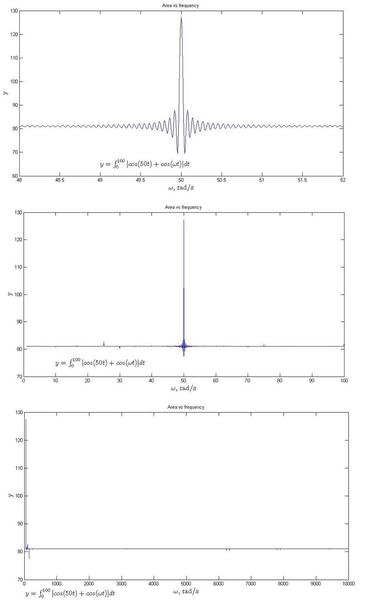

yeah, numerical integration. If you can do a little programming like that, you can plot the area of the integral as a function of the frequency to find an approximate answer to your question.
As for whether it's global, just cover a large range of frequencies to be sure. This way of doing things isn't a formal proof.
I wonder though, whether the ratio is constant or dependent on the fixed ω. It's also very possible too that the area is max only when the two frequencies are equal (not considering frequencies less than the fixed ω).
I ran it in matlab. I changed a few things, but the equation used is shown in the plots.
There's 3 plots, at different scales. as you can see, the maximum occurs when the frequencies are equal.
