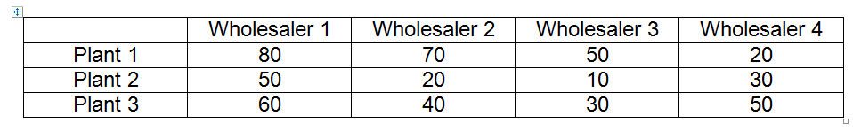

The BFE company produces its own financial calculators at three plants for four wholesalers. The three plants will produce 60, 80 and 40 units, respectively, during the next time period. The company has made a commitment to sell 40 units to wholesaler 1, 60 units to wholesaler 2 and at least 20 units to wholesaler 3. Both wholesaler 3 and 4 also want to buy as many of the remaining units as possible. The net profit associated with shipping a unit from plant i for sale to wholesaler j is given by the following table:
Management wishes to know how many units to sell to wholesalers 3 and 4 and how many units to ship from each of the plants to each of the wholesalers to maximize profit.

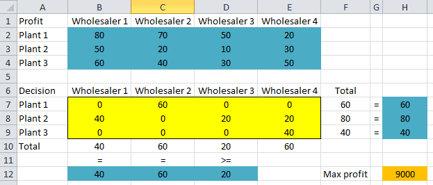

Well, this is what you get if you put it into Excel.
That's it for today. Going to sleep now. (Sleepy)
