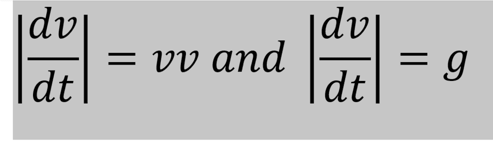

Position of an object is given by y(X)=sin(x), and moves with constant speed v. Find the maximum speed given that, the acceleration at the top shouldn't exceed g.
a=dv/dt
I got the correct answer which is √g. I solved it as if it were a circular motion with radius of 1. But got no idea why my solution did work.

Is it true this way because it will be a rotating vector, or I just got it by pure luck again😭😭😭
not sure though why should it v times v
You know that ##y = \sin{x}## describes the trajectory of the particle, and you want to find something relating to the acceleration in the ##y## direction, ##\frac{d^{2}y}{dt^{2}}##. What happens if you try finding the second derivative of ##y## with respect to ##t##? Then, what values can you substitute into this expression given the critical condition in the question?
You'd need to justify dv/dt = v2. Where did that come from? Remember |v| is given as constant.
that's from the rotation of axis. Like any vector. dA/dt= A*w. where w is the rate in which it changes it's direction. Not sure why this vector change it's direction by magnitude of v

Yes sir sorry for my messy writing, this what I am trying to figure out, the left hand side is " |d→Adt||dA→dt| clearly g, the ##|\vec A|\## is v, but I don't get what's w
So how do you get ##|\frac{\vec{dv}}{dt}|=|\vec v|^2##?
w must be equal to v, but I don't know how to define w. like what's it's formula
